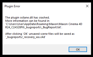

Hello,
The same thing happens to me. 90% of the time when I try to render, it crashes. Please see attached for the bugs report, really appreciate it if anyone could help.
Below is my detail;
A. Windows 10 64 Bit
B. NVIDIA GeForce RTX3090
C. 32GB RAM
D. Nvidia driver version 471.41
E. OctaneRender Standalone version, 2020.2.4
F. OctaneRender c4D plugin version 2020.2.4-R2-win
G. Host application version, Cinema 4D S24.035 (RC)
H. Attached is the error that pops out
I. Attached is the bugs report
Below is my detail;
C. 32GB RAM

Hi saifdean93,
please post an octanelog_report.zip, c4d bugreport is not enough.
Please, open the scene, then go to c4doctane Settings/Log Output tab, and enable all the Log option checkboxes.
Then, load the scene in Live View, then in Picture Viewer, or until crash, then reopen c4d, navigate to c4doctane Settings/Log Output tab, press the **Generate log report** button, and share the octanelog_report.zip file, thanks.
ciao Beppe
