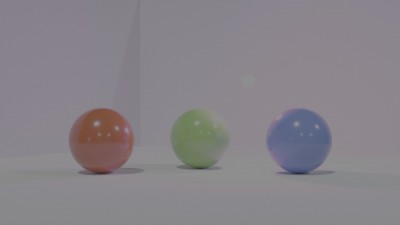

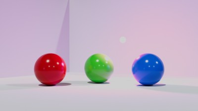

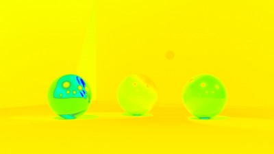

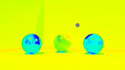

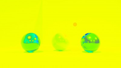

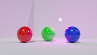

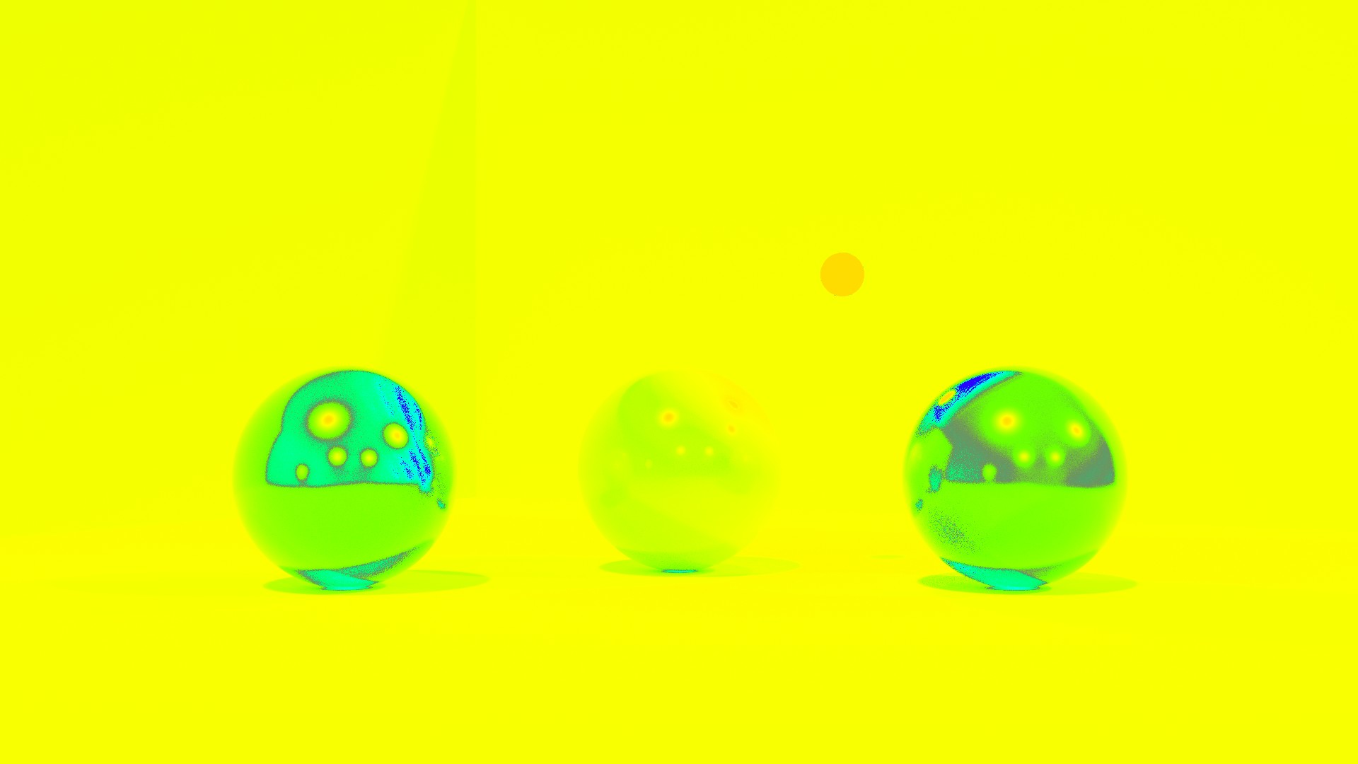

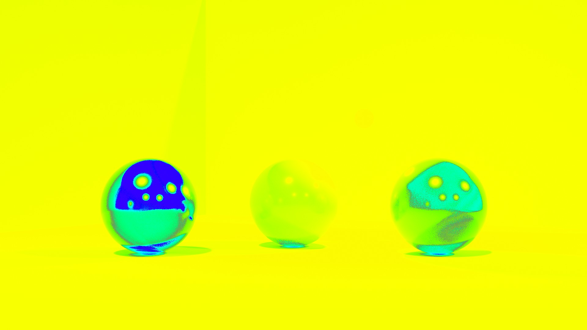

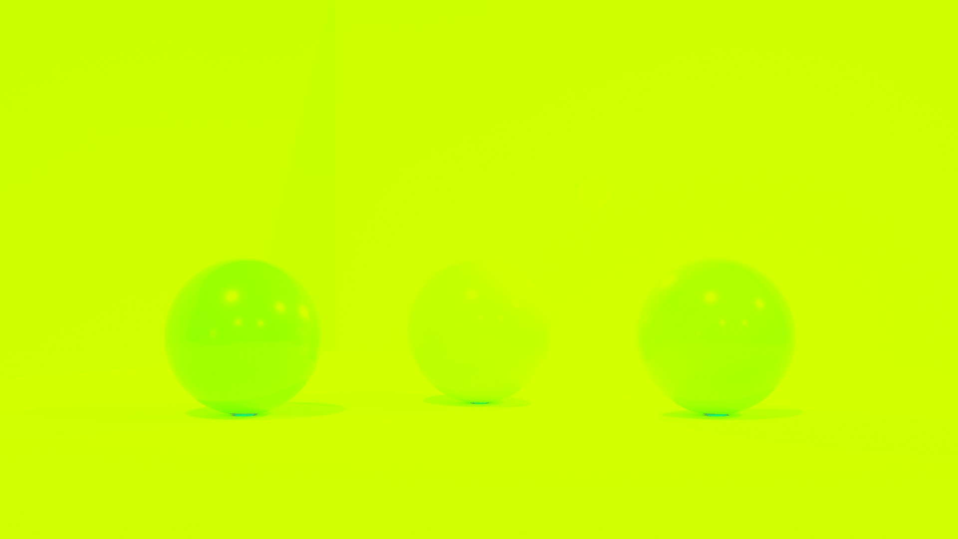

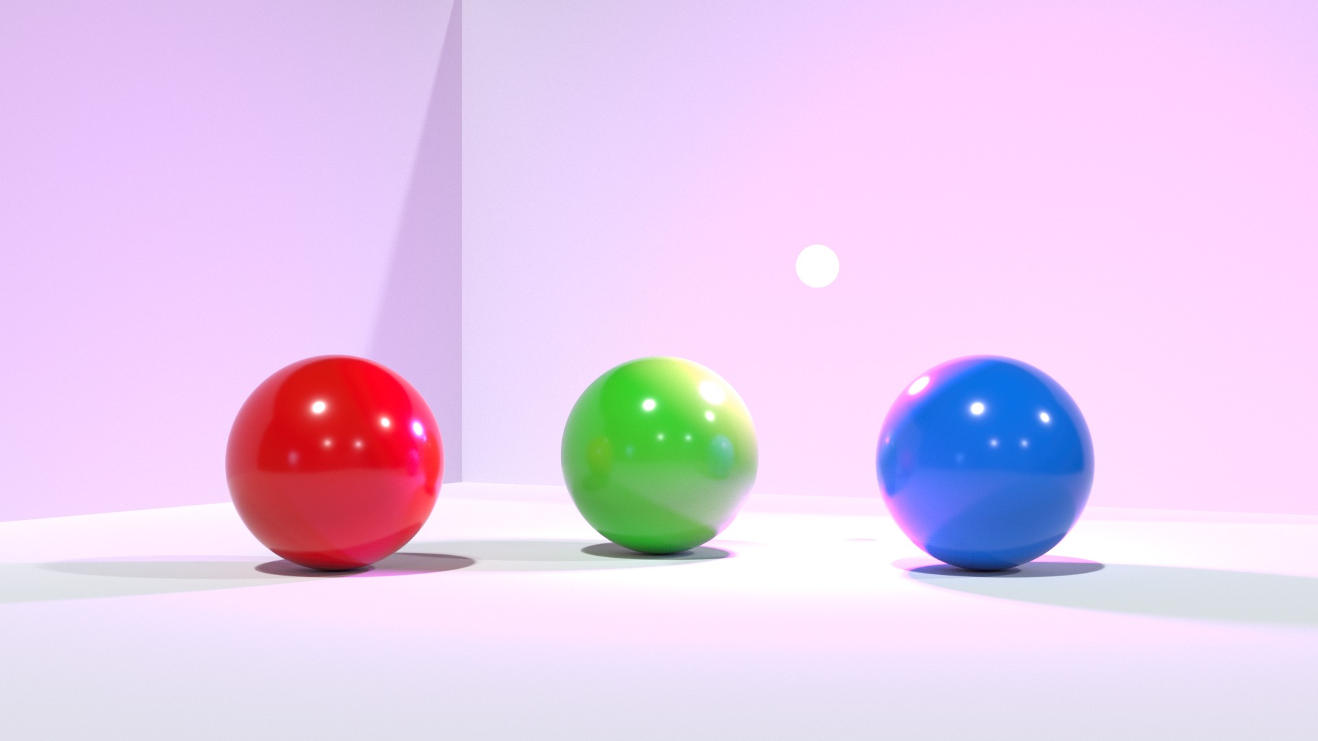

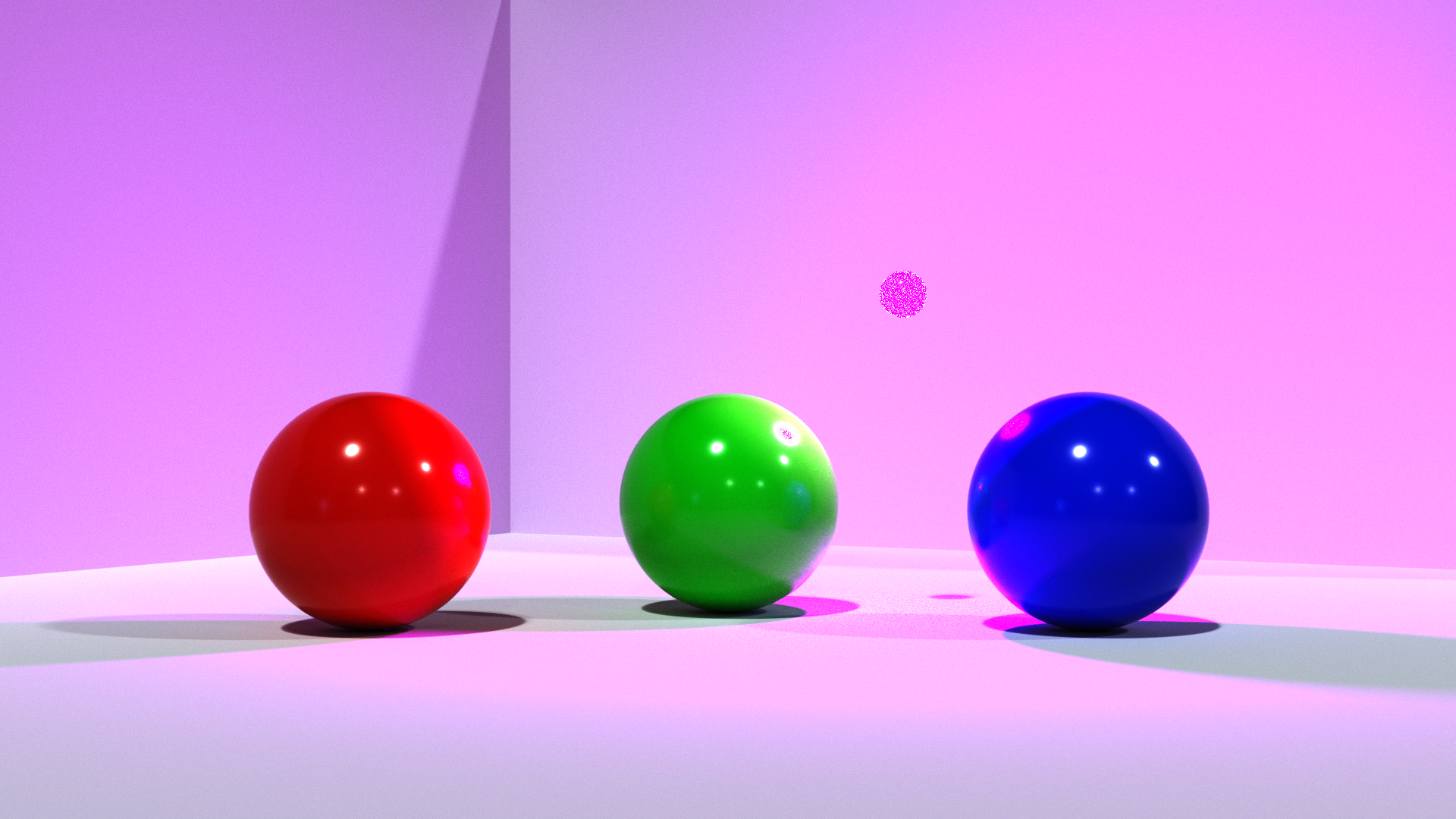

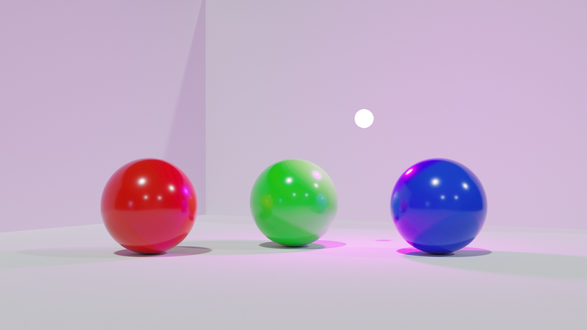

So in the end I ended up doing a comparison of ACES to filmic because what I realized is another setting was affecting how it looks out of the box, but I did a lot of tests just to compare.
Linear
Linear
Linear False Color
Linear False Color
OCIO 1 Filmic
OCIO 1 Filmic
OCIO 1 Filmic False Color
OCIO 2 sRGB LOG
OCIO 2 sRGB LOG
OCIO 2 sRGB LOG False Color
OCIO 2 ACES SDR Video
OCIO 2 ACES SDR Video False Color
OCIO 2 sRGB Un Tone Mapped
OCIO 2 sRGB Un Tone Mapped False Color
I am not entirely sure which if any of these I would actually like to integrate full time. To be completely honest, I am not overwhelmingly impressed with anything except maybe SDR video but the highlights worry me a bit on all of these except filmic. If you look at the gradient from highlight to shadow in the false color you will see what I mean. I dont feel like its actually packing more data into a smaller spectrum of values... I feel like its packing maybe a small bit more data in and then clipping off the rest. You can see from the large block of yellow with no real gradient followed by a short gradient in the light falloffs. Something just feels wrong about the curve, but I also havent tried any of them in an editor to compare how they edit. I am making this statement purely on my visual analysis I feel as though there must be some info out there on what kind of workflow to integrate with this.
