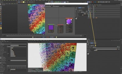

I am trying a scene where X Particles are being emitted from a texture. The are able to take color values from the texture itself. But How do I make it visible in octane?
See attached image below
Please help!

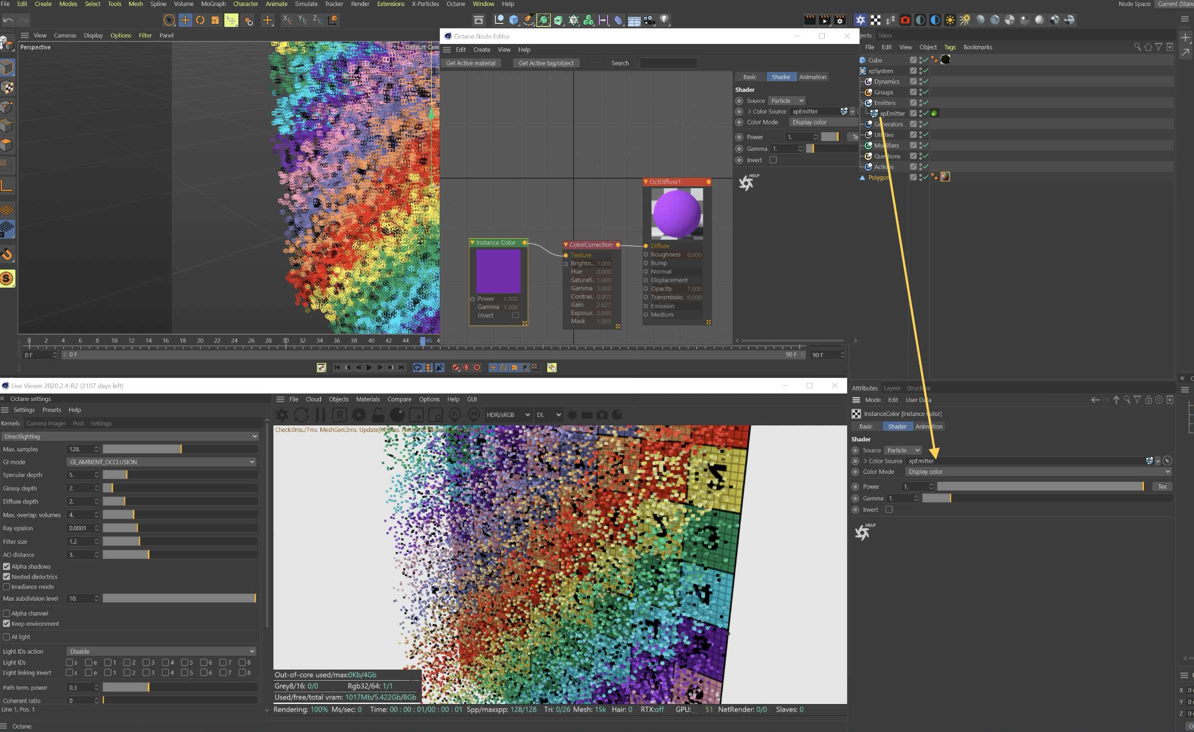

have you tried with the Instance Color node, with the Emitter as source?

YES THIS DID IT!!! Thank you so much :)
