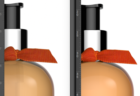

If I avoid rendering to the picture viewer then it doesn't crash so much. However when I save from the Live Viewer, no matter what colour options I use, the saved file looks different from the live viewer, and different from when I render to the Picture Viewer. It's more saturated and contrasty.

No crashes using the live viewer so far. So it's something to do with the picture viewer. I often find Octane crashes right at the very end of rendering to the picture viewer.
