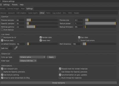

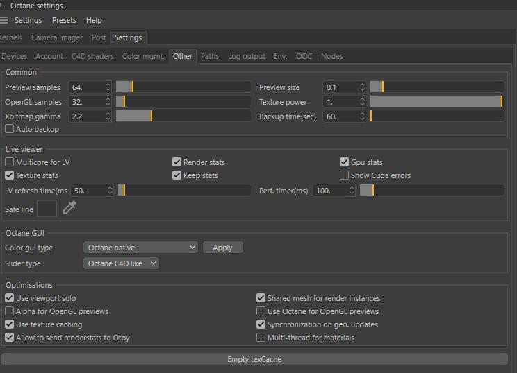

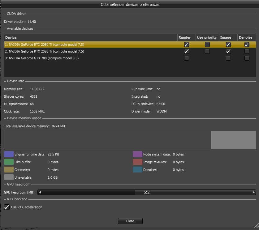

Hi Luva,
please upgrade Win 10 to 2004 or greater and report back, thanks.
