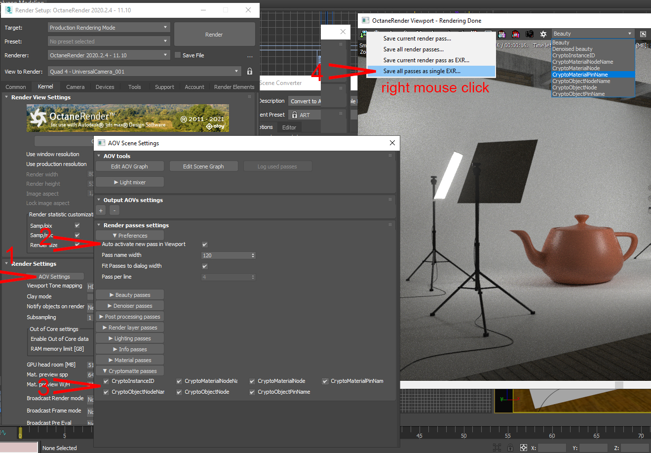

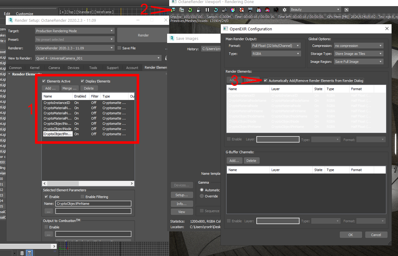

wondering if it was possible to output multilayer EXR, with it Cryptomattes layers, from the Octane Viewport.
I'm used to work directly from Octane viewport and I don't like to render through Max Frame buffer.
always saves in separate files.

Hi MartinBoom,
Regards

Hi Martinboom,
next plugin release will fix a little issue so you will able using this workflow as well.
Regards
