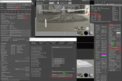

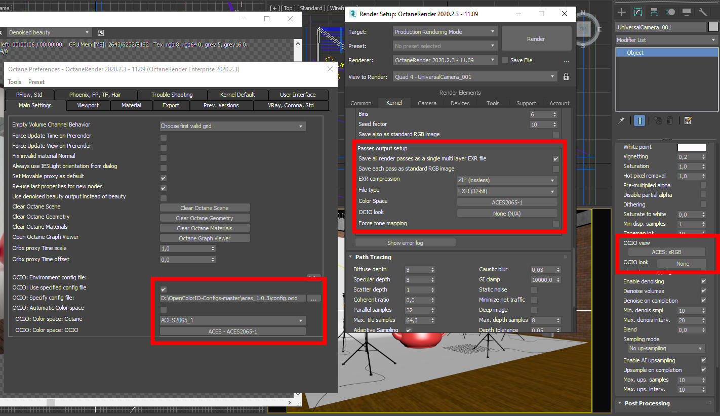

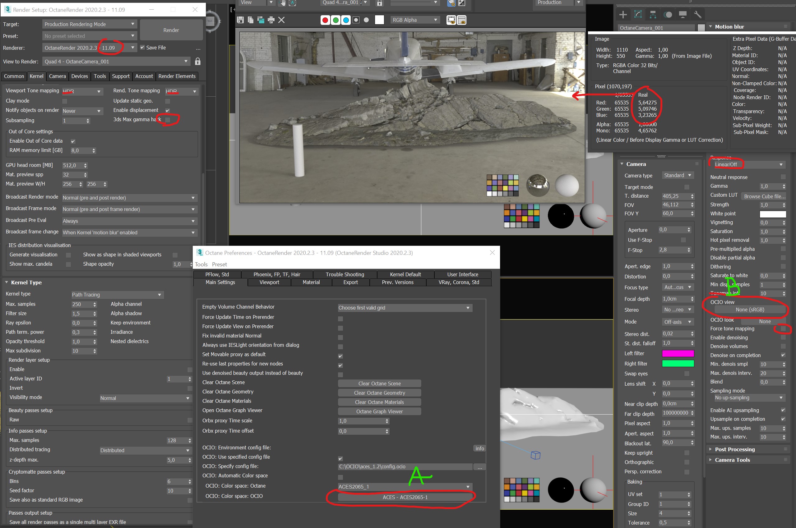

NOTES for the screenshot attached:
A: Whatever i put there... the render is always being saved in => ACES2065_1. If i put ACESCG.. it's not saved in ACESCG.
B: If i put something there.. all pixels above 1 are clipped when saved to the exr file... so what's the point of using this? to preview? Well the preview is wrong... if you put ACES:SRGB.. it does all wrong...
i tried turning on force tone mapping on/off , gamma hack.. all combinations... and i am not satisfied why it's so difficult to get it like in cinema4d...
Hope someone can point me in a better direction... I just want to save a perfect ACESCG exr file with no clipped pixels.. that's it...

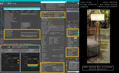

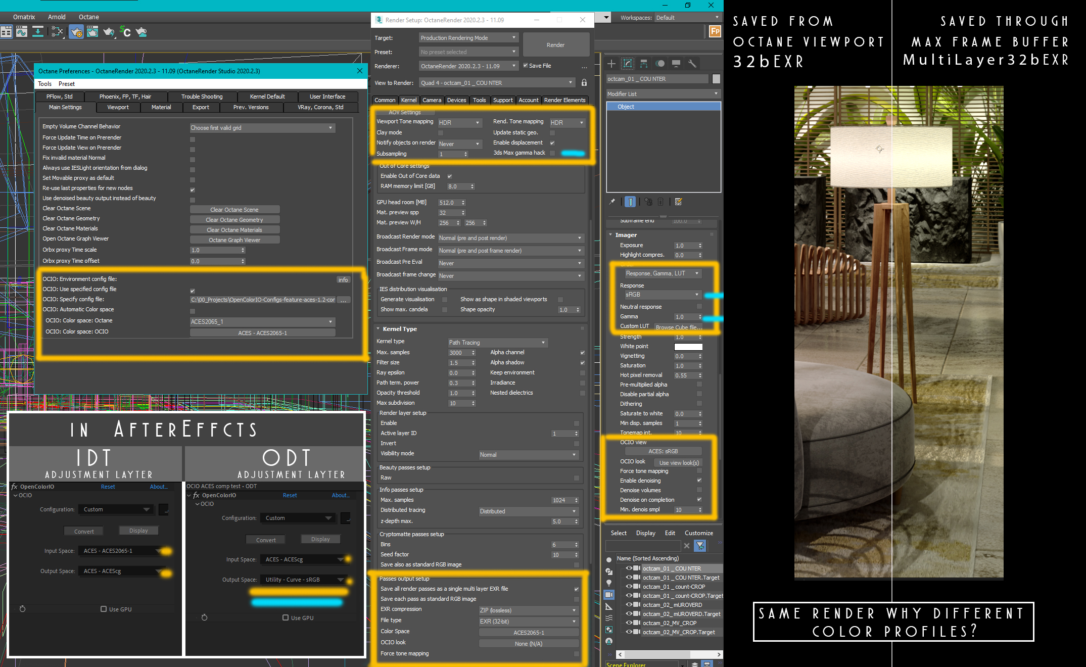

Hi
this is my current setup for using OCIO-ACES and exporting and is the one that works with AE (i mean..the image looks closer the the Octane viewport)
im seeing something really odd, though.. If you save from Octane viewport (EXR 32 etc) the image has a different color profile
that if you save through 3ds max Frame buffer to a MultiLayer EXR and use the exr Extractor in AE.
for all this to somewhat work in AE i have to put the ODT input sapace " ACES - ACEScg" output space "utility - curve - sRGB" other than that the image looks terrible (i've tried a lot of profiles)
IF we dont get feedback about this im opening another post to get attention. is that work?
cheers
martin

hi martin! sorry i could not see this before.MartinBoom wrote:Hi
cheers
martin
this is my after effects setup... from top to bottom. And it's working fine insdie AE:
layer 1 => here the ODT which is => "ACES - ACEScg" to "Output sRGB" (this layer is a guide layer.. not to be rendered if you export to exr. But yes if you export to a mov for srgb monitor)
layer 2 => your color corrections... (you can overxpose to check if all overxpose nicely
layer 3 => ocio=> from "ACES - ACES2065-1" to "ACES - ACEScg" (you change the linear aces2065-1 that octane renders to ACESCG linear)
layer 4 => octane render.exr (imported as preserved rgb, color management off, 32 bit on) You should see it very dark (as your are seeing it linear
Hope this helps!
I will give another try again to paride settings... as they didn't worked so far before.
