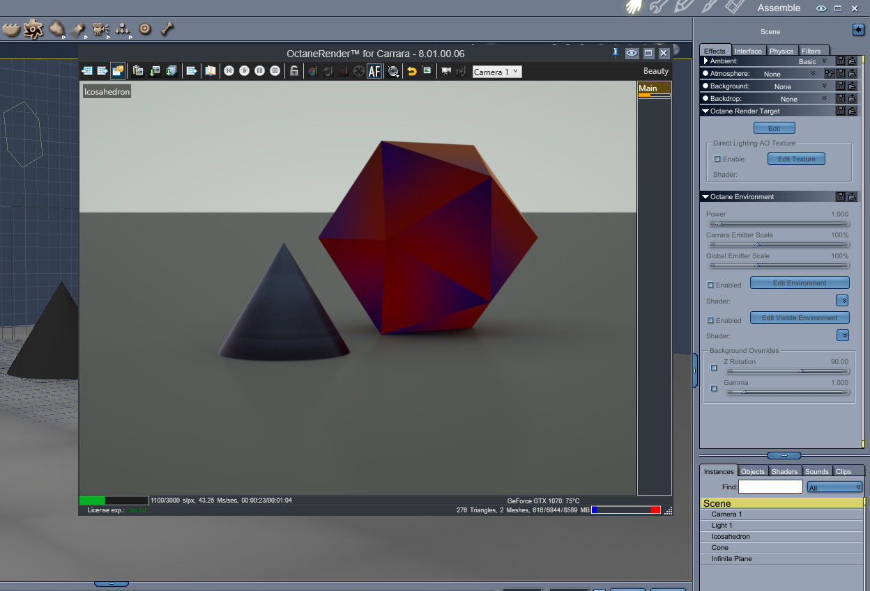

New question, I found that the place where you can fiddle with the Octane Environment settings and where you can change the render target (the place where you can switch the types of rendering done) which is located in the 'Effects' tab of the carrara Scene when selected from the instances tray, however it's completely greyed-out so although I can see the options there, I can't interact or change anything. What do I need to be doing to enable this so I can make those controls useable, and what am I doing wrong?

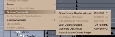

Well, it is true that the 'Activate' button on the About/Activate window is indeed greyed out, but I think that's just because it's already activated. The Octane render window comes up and renders just fine now, I just can't really change the environment or the render target, which is inside the 'Effects' tab of the Scene itself. Can't figure out how to upload a pic or I would show a screenshot...
Now that I'm learning when I decided to try the latest version of OctaneCarrara that it relies on a different license than my old perpetual license, so I only got it working because I 'rented' a Studio license for a month. Maybe the Studio license has other limitations of what it can do? Or maybe I need the Enterprise license to unlock the Octane environment controls and the Octane render target controls? Perhaps if I downgraded back to the old version that I bought the perpetual licenses for, those functions would then unlock again and not be greyed out? Or maybe I'm just missing something obvious...
