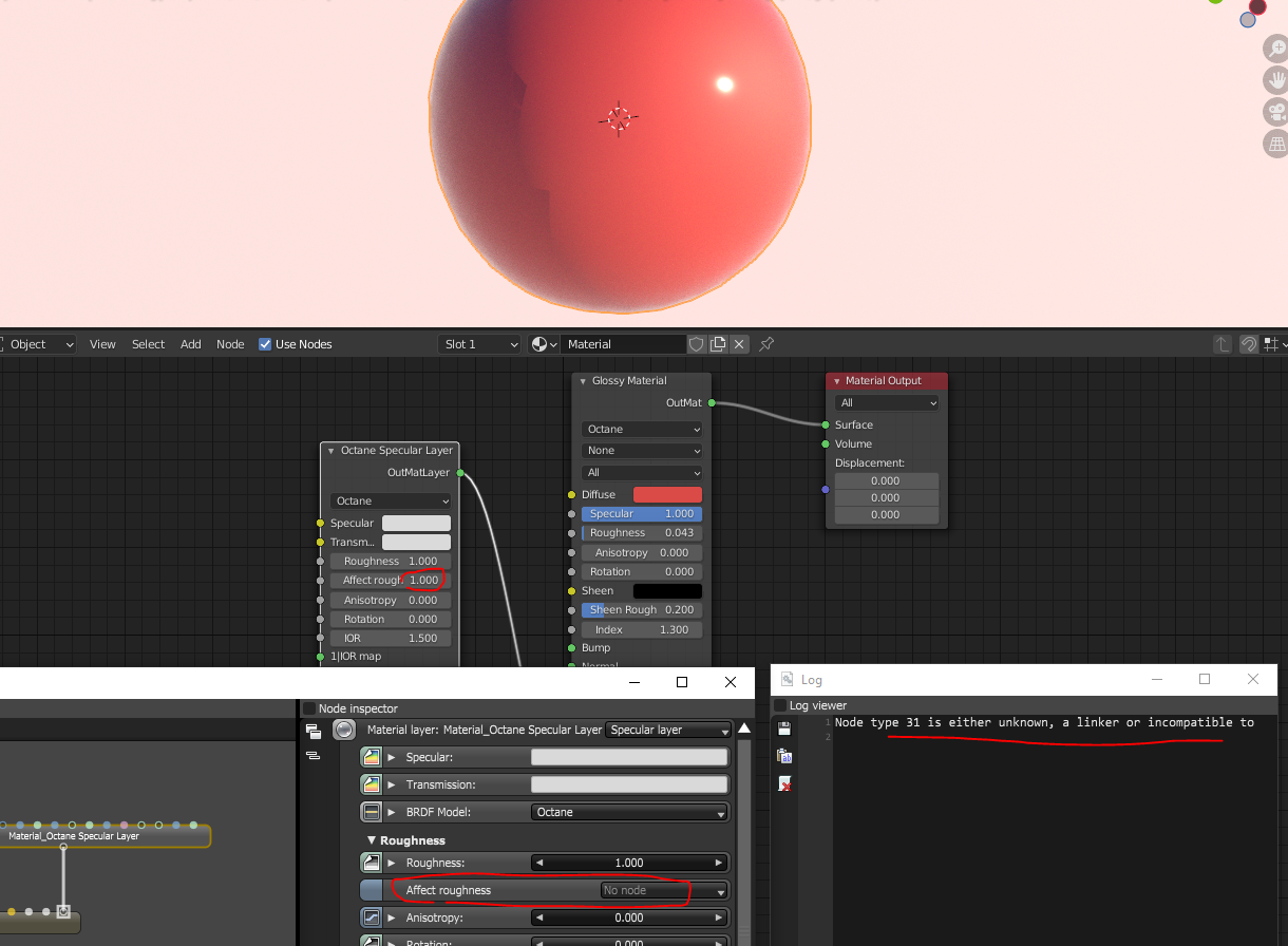

"Affect roughness" on the "specular layer" and "sheen layer" nodes is not working.
You can see the following errors in the Octane log:
Node type 31 is either unknown, a linker or incompatible to static pin 'affectRoughness' (P_AFFECT_ROUGHNESS, type PT_FLOAT) of node 'Material_Octane Specular Layer' (NT_MAT_SPECULAR_LAYER, 0000027081983860)
Node type 31 is either unknown, a linker or incompatible to static pin 'affectRoughness' (P_AFFECT_ROUGHNESS, type PT_FLOAT) of node 'Material_Octane Sheen Layer' (NT_MAT_SHEEN_LAYER, 0000027080D20A60)
Affect Roughness on Specular and Sheen layer not working

The same bug affects 24.0
