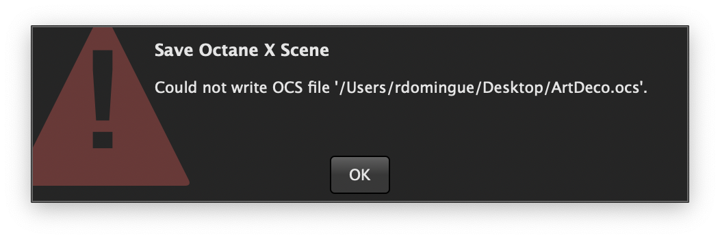

Tying to save an .ocs document in Octane X. However, I'm able to save an .orbx package and unpackage it then open the .ocs file and then save. But I can't save to any directory as an .ocs initially. I'm using a non subscription license of on my Mac.

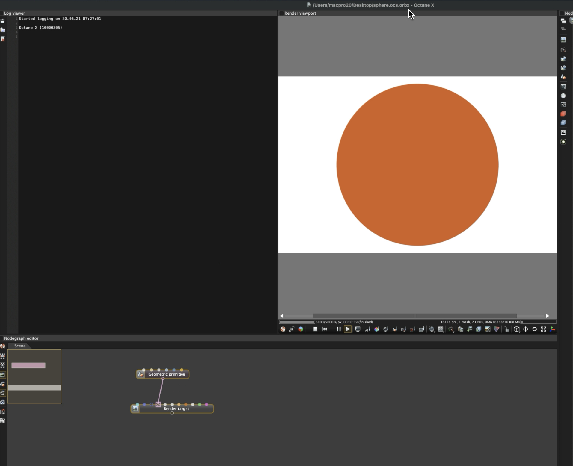

Ok, just tried with OctaneX from App Store, and you are right, it is limited in saving only .orbx scenes, no .ocs saving, if you force to save in .ocs, it will be saved as .ocs.orbx:

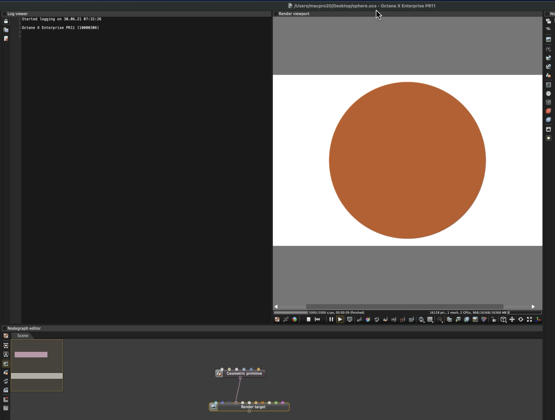

But there are no issues with Standalone PR11, you can find it by visiting your personal Downloads area:
https://render.otoy.com/account/download_archive.php
