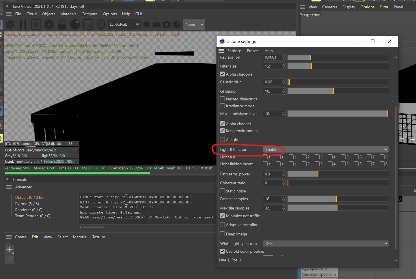

This parameter is disabling the all lights. I think you changed it accidentally.

It's part of light linking feature. When you set it enable, all unchecked IDs will be inactive. That's why you have black output.
