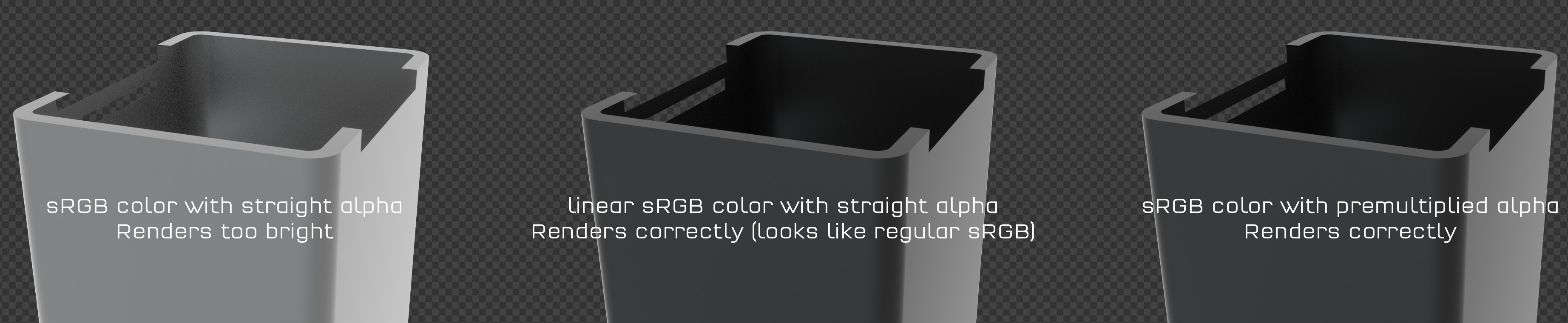

Since octane 2020.2.4 the setting: "Render settings > octane render > main > color space" has had sRGB and linear sRGB reversed. All my srgb renders are coming out pale and washed out with linear colour space and all my linear srgb renders are coming out as darker. This is only since updating from 2020.2 to 2020.2.4
This also seems affected by switching from premultiplied alphas + keep background and straight alphas + not keeping background

There's literally a faulty project and a series of images illustrating the problem, how fan you possibly say this is how its supposed to work?
Why does an sRGB render with a straight alpha look completely different from one with a premultiplied alpha? The only difference should be the slight fringe around the outside.

Well, I didn't get which parameter you was talking about. Capture makes it clearer. Will check why it happens
After checking a little bit, it's about color profile change if you select "straight alpha". Your sRGB image profile internally becomes "linear" in the case. In new color management system of plug the thing is a bit complicated.
There's a few things to work-around: using LDR-8bit render buffer or using a different image format with linear profiling. Not sure If I can bring a safe solution for that in future.

Rendering out to 8 or 16 bit 0-255 formats (png in my tests) with a straight alpha gives washed out renders. The alpha channel type is still affecting the rendering/saving colour space/gamma
