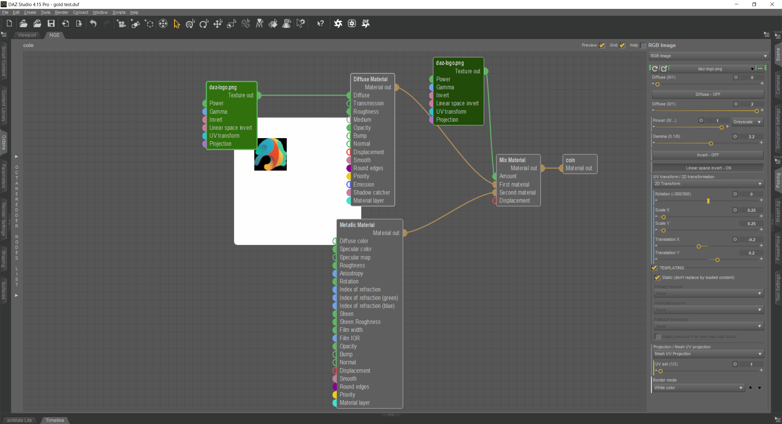

here's a look at the node structure I have.
Can anyone help me?

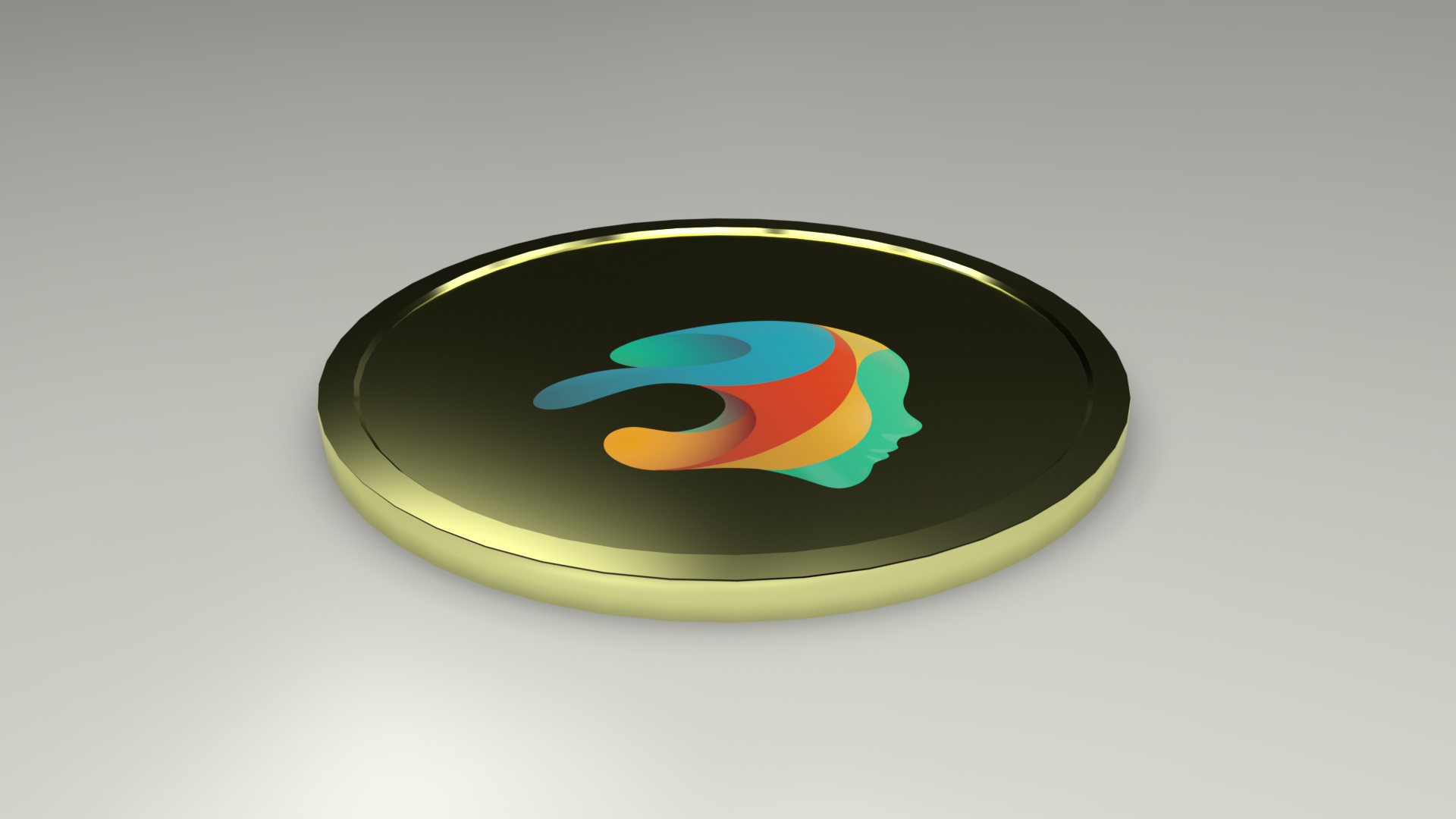

So I put the DAZ logo on a gold coin. Is this close to what you are trying to achieve?

Banti wrote:So I put the DAZ logo on a gold coin. Is this close to what you are trying to achieve?
Yes indeed .. this is what I'm trying to do. Can you show me how you did this please.

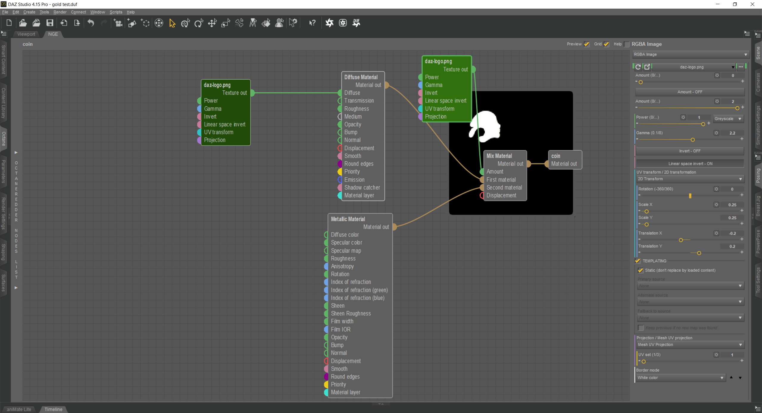

I mixed a Diffuse material and a metallic materials. I put the logo into the diffuse channel (as rgb image), tweaked the scale and translation so its centered and the exact same image into the amount channel of the mix node (as rgba image because it has alpha channel). I switched border mode from wrap around to white color (so it doesnt repeat). And thats pretty much it.
