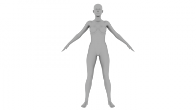

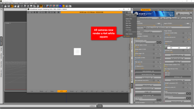

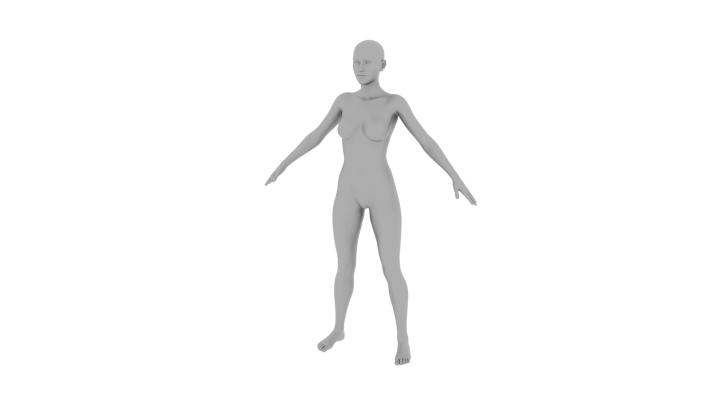

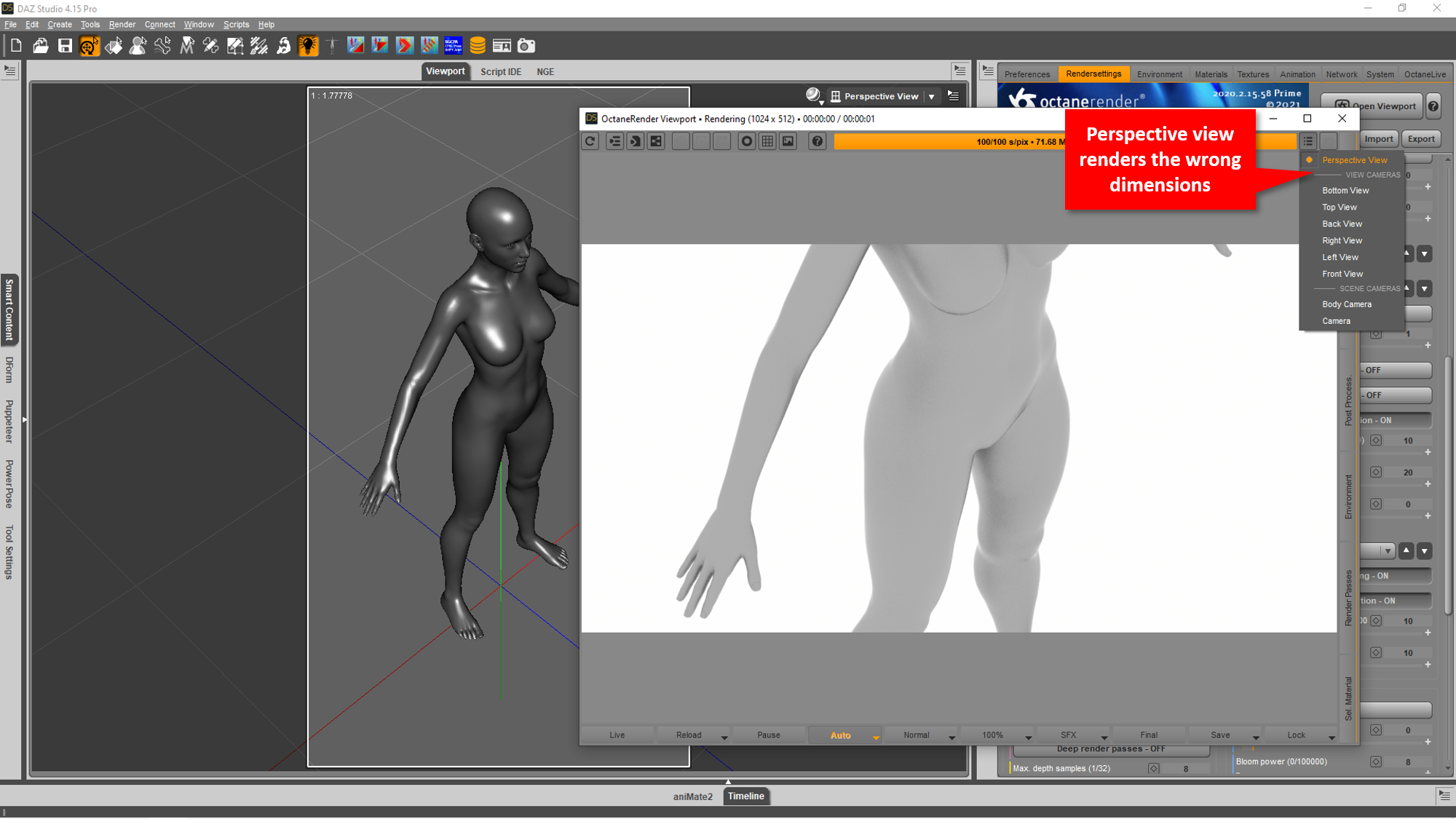

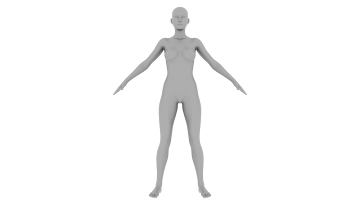

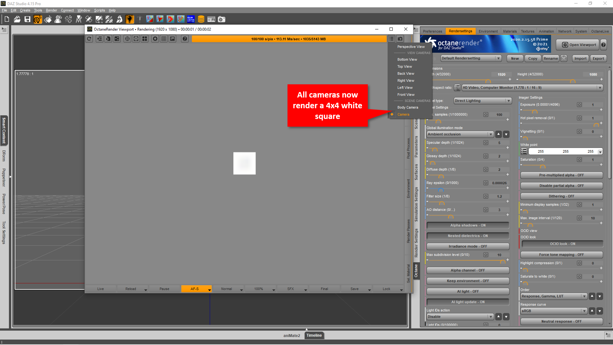

Struggling with an unpredictable bug: randomly my camera renders a 4x4 white square. Once this happens to one camera in the scene it happens to all cameras in the scene, and at the same time the Perspective View resets to landscape even though my Studio aspect frame and render settings are set to portrait. I cannot determine what causes the error and once it happens I cannot change anything to fix the problem. The only thing that works is deleting all cameras, deleting the Octane scene node, saving the scene, restarting Studio, reloading the scene then re-creating all cameras and Octane render settings. Are these symptoms familiar to anyone?
Attached screenshots (in reverse order so start from the bottom picture and move up) show the camera render before the problem (pic 1), the Perspective View render before the problem (pic 2), the 4x4 white square camera render after the problem (pic 3) and the incorrect Perspective View after the problem (pic 4).

Maybe this helps:
Check the camera settings:
- turn "use local dimensions" ON and it will render only 4x4 pixels
- turn "use local dimensions" OFF and the preview renders just fine.

Thank you for the suggestion; confirmed that works for me too. Camera local dimensions ON = Octane render dimensions error. Camera local dimensions OFF = Octane renders correctly.
