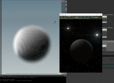

So I made a spherical isosurface volume to create a planet atmosphere, set it to Octane Volumes, and then used an Octane Volume Medium as follows, but it is not showing up:
Help is appreciated and thank you
IsoSurface Volume not rendering

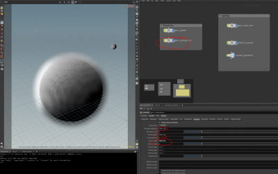

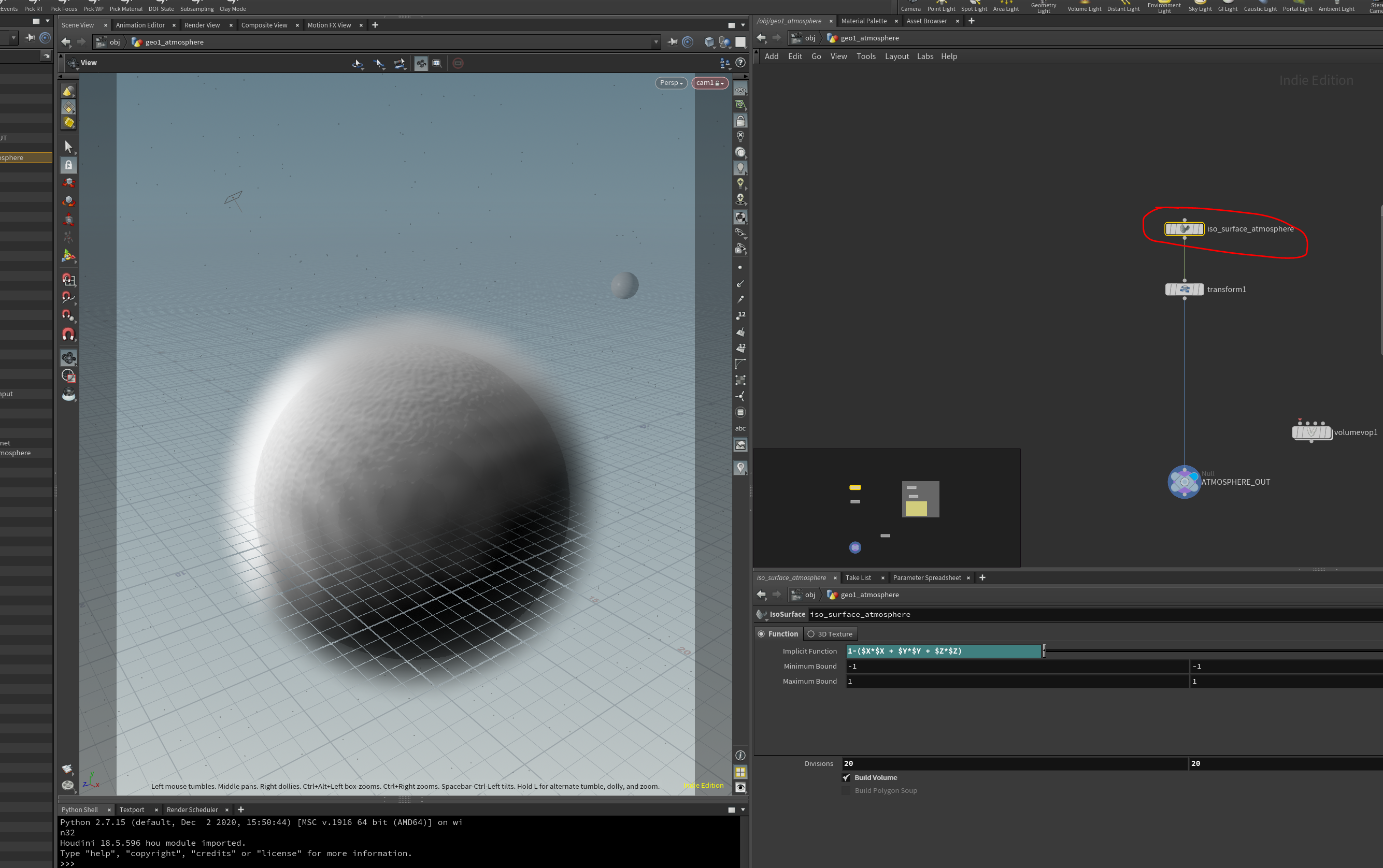

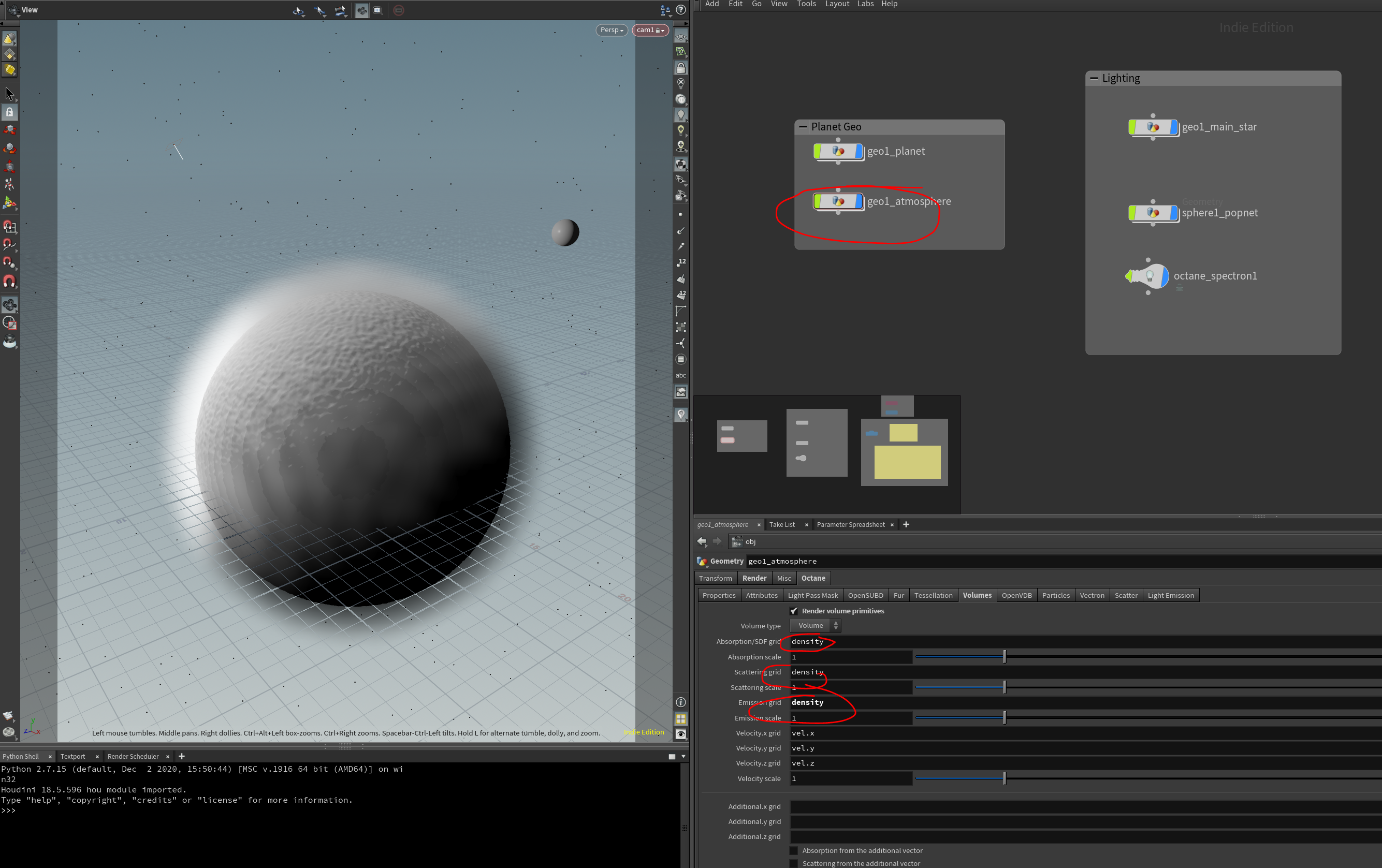

Did you give it a name. In the isooffset node you’ll have to name it density because the isooffset doesn’t do it automatically.
Thank you Rohan that worked, naming the isooffset to density. I guess this is the only way currently to do atmospherics for now I am guessing. Now I have to figure out how to do a falloff from the surface haha. By the way I bought your Octane volumetric series, thank you so much they are very helpful.
