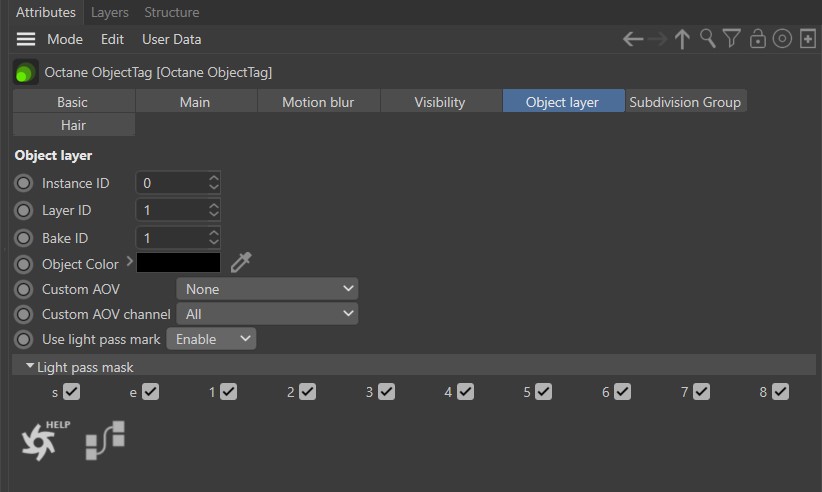

Hi All,
Got a specific need to have two different HDRI setups in a scene for two different objects. Is there a way to do light linking or exclusion with those?
Thanks!
Posts: 16068
Location: Türkiye
You can adjust the effect of light IDs from this tab.
crowellster
Posts: 36
Joined: Tue Feb 16, 2016 12:13 am
Thanks Aoktar--but am I able to assign a light ID to the HDRI Environment Tag?
Posts: 16068
Location: Türkiye
'e' means environment light. Just deselect it
