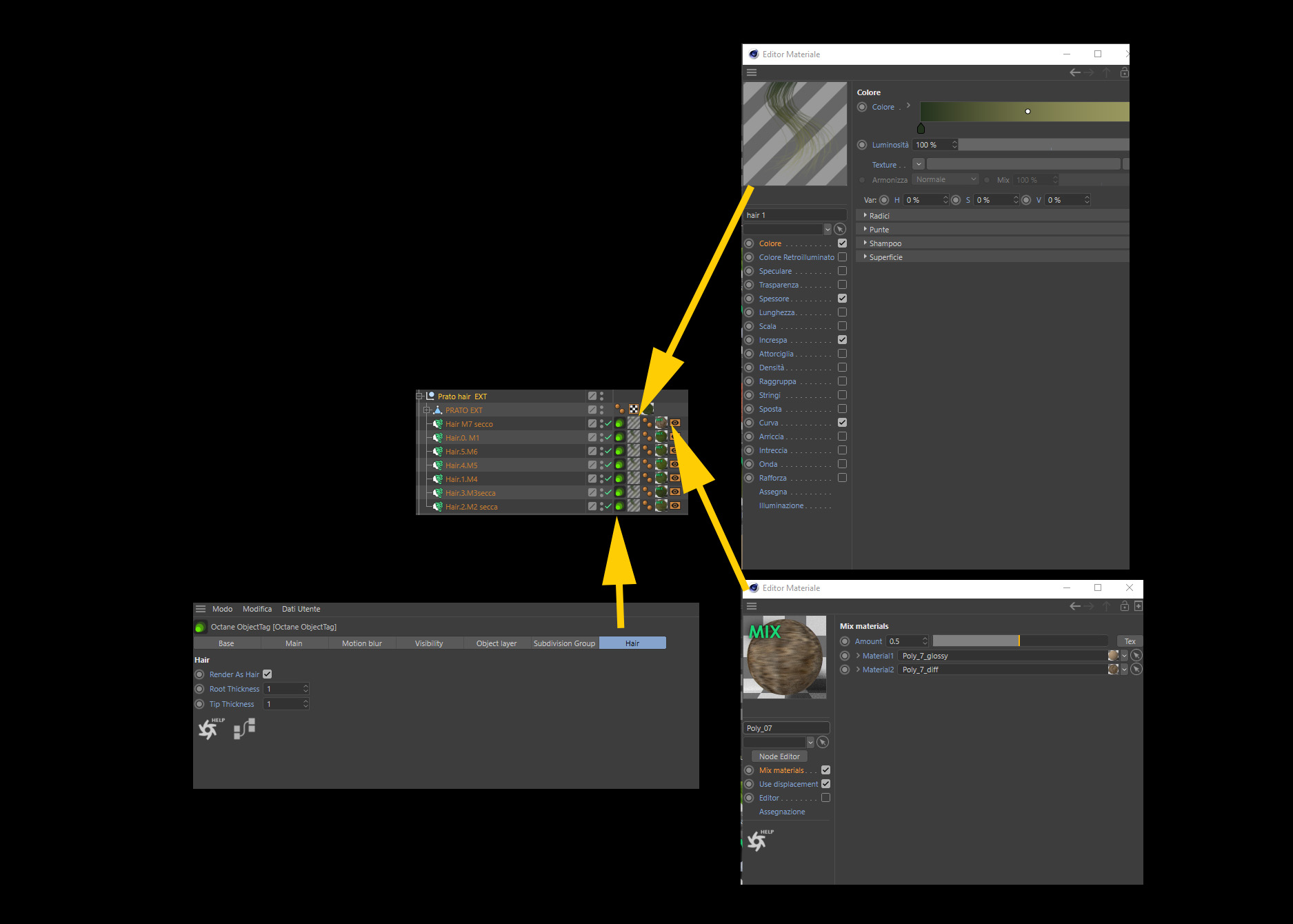

I haven't found a lot of documentation about how to realize a hair grass field, so I've remained with my old method that is the one in the image enclosed.
But I've noticed that in this way the render is really toooooo slow and eats a huge quantity of memory.
Someone could share a much more efficient way to use hair with Octane 2020?

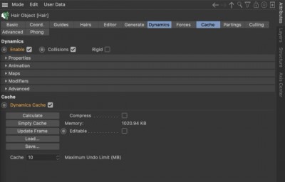

Did you cache your Hair before loading in GPU?
ciao Beppe

Ehm... I ignore the possibility to cache hair before rendering..
So what should be your suggested way?

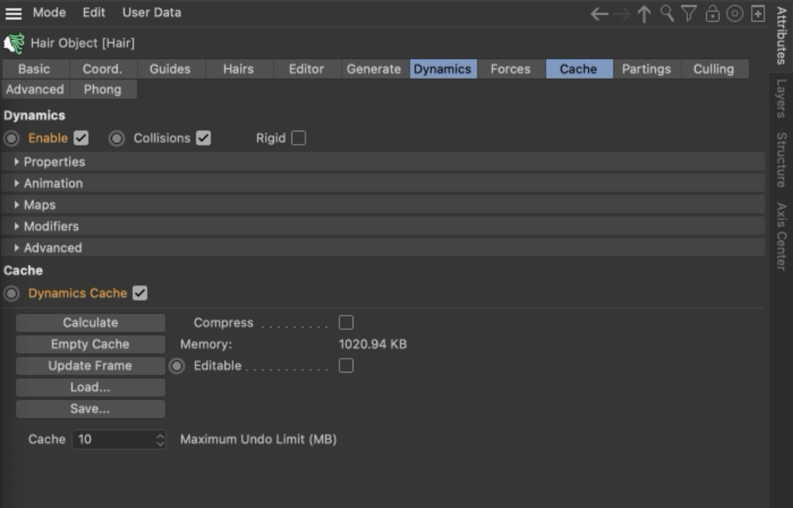

On the other side, if you need dynamic effects and collisions, Hair is perfect, but better to use it in restricted areas, and always calculate the Cache before loading in Live View: ciao Beppe
