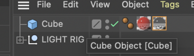

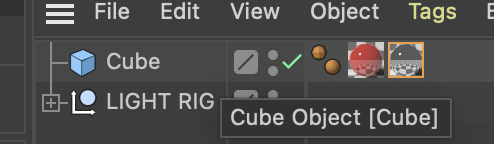

What's the best way of fading out a material slowly so that the material behind it shows?:
Fade
Fade
I'd like to fade out the glass material to reveal the red material
Would I have to use a mix material?
atoyuser1
Posts: 212
Joined: Sat May 02, 2020 1:10 pm
Ignore me, I have answered my own question. Mix material all the way!
