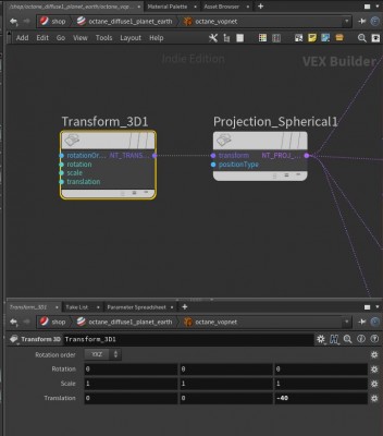

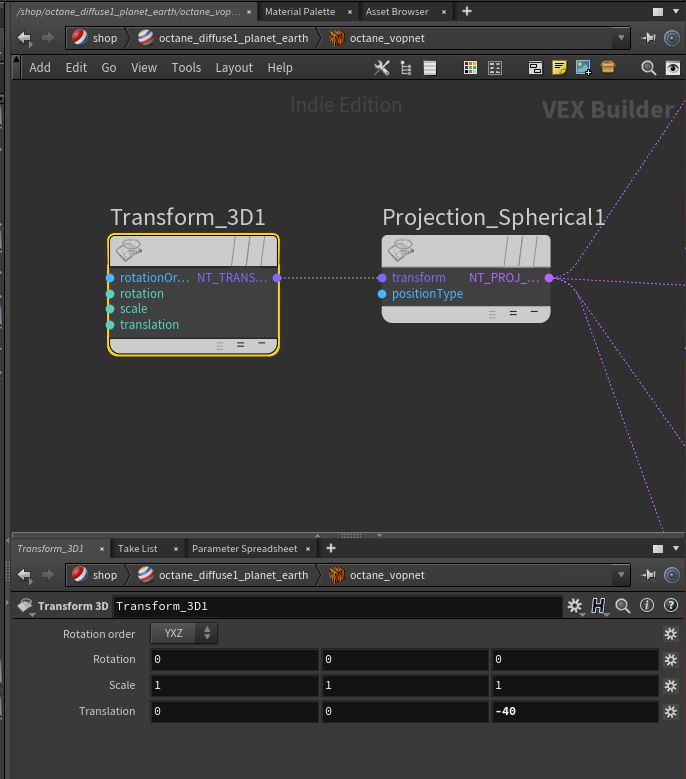

juanjgon
Posts: 8867
Location: Spain
You could also add a transform node to the shader to match the sphere translation or rotation, but well, I think that a proper UV mapped sphere is the best solution to avoid problems.
