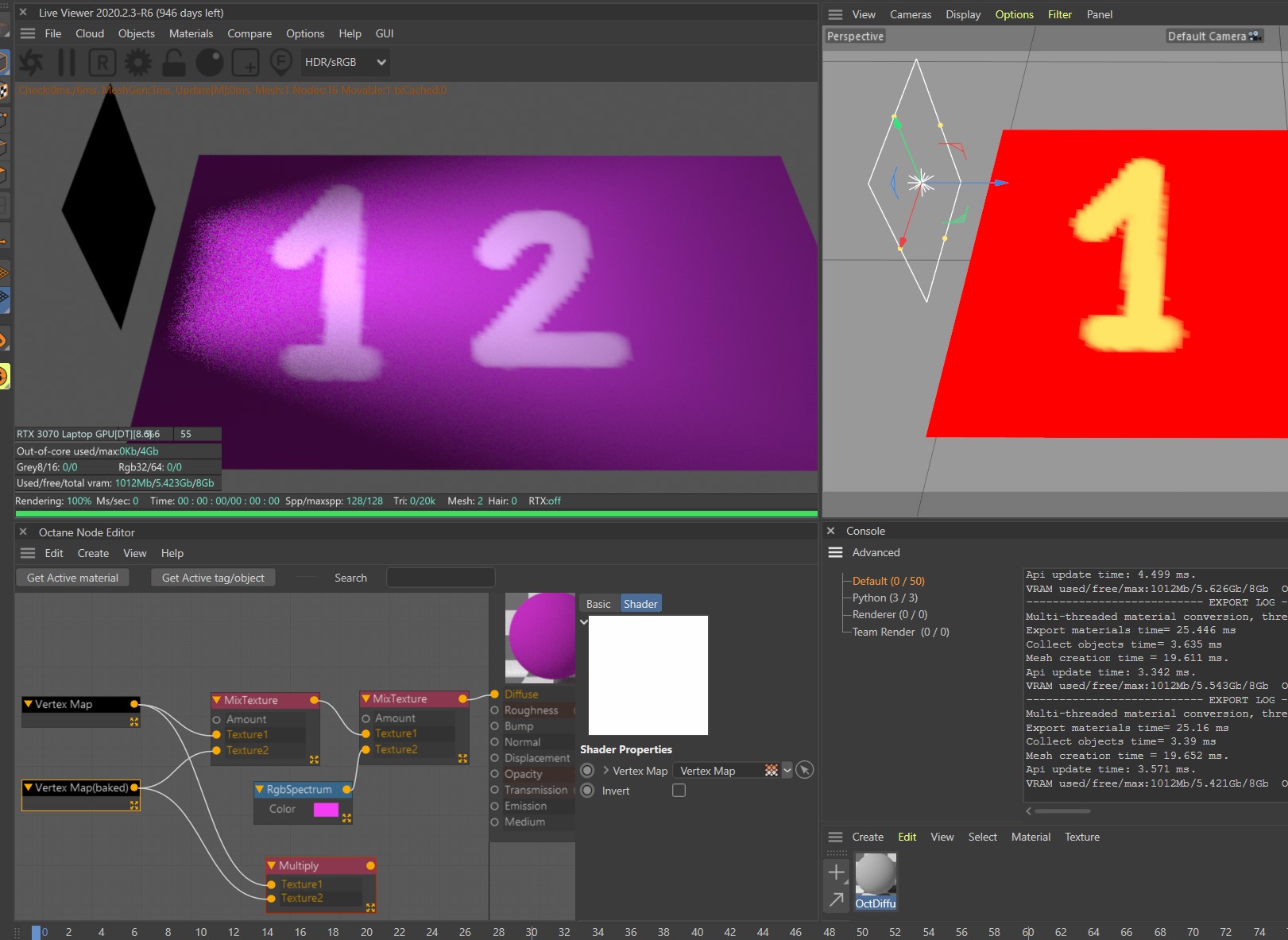

Vertex map mixing may not be working in 2020.2.3 R6?
I'm bouncing back to 2020.1.5 to get vertex map mixing to work.
Anyone else able to confirm if this is occurring for them as well? -- Just a basic vertex map material setup - (using it to mix materials or on a single material) - doesn't seem to work in any scenario I can come up with

Vertexmap related revisions we have but I don't think it avoids the anything for texturing. And It's working here. It will great if you share the related part of the scene to show the issue.

doesn't to work

lyw9527 wrote:doesn't to work
Can you try English chars to name it?
Thank you. It really need to use English to work normally
