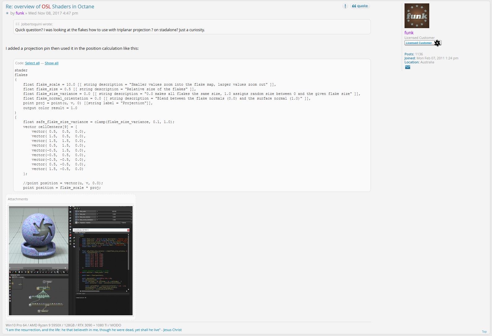

The re-purposed Chaos Group flakes map that comes built into Octane has a projection pin that was added here:

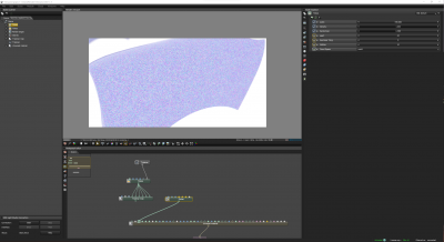

I exported some geometry that has no uvs to test. Here is the Chaos Group/Octane native OSL node:

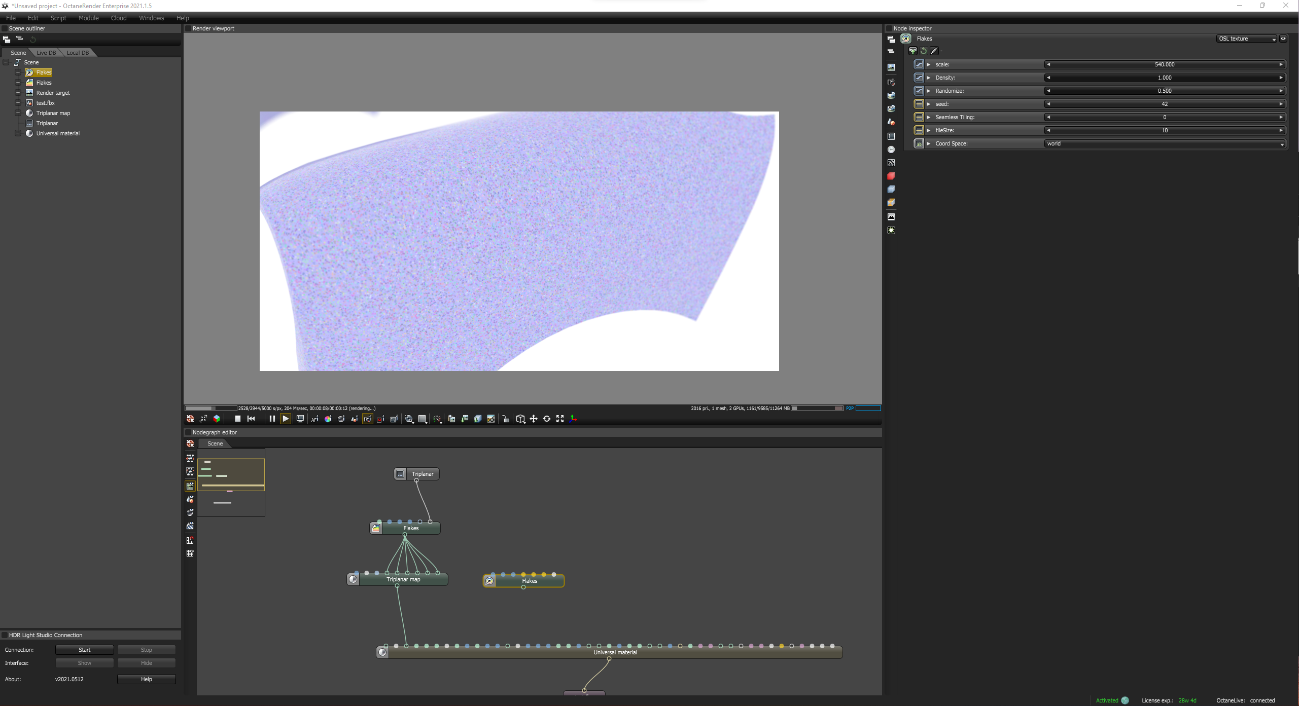

The better OSL Flakes from this thread doesn't have a projection pin slot. However I think it might be built into the OSL code.
If I switch the new flakes OSL to UV mode then I get nothing (which is expected because there are no UVs)
If I switch it into world or object mode then it seems to apply automatic mapping somehow.
Seems to work well.
