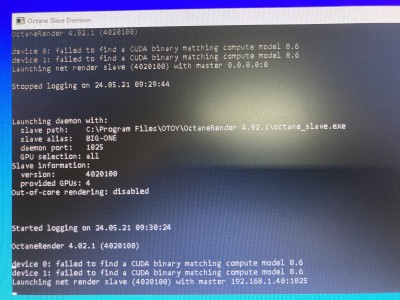

I have added two 3080 CG on my rendering rig and it seems there is an issue (compute model 8.6) with these two CG.
Is there a way to fix that ?

Ampere cards are not supported in version 4. You'll need to upgrade to the latest version to use them.
