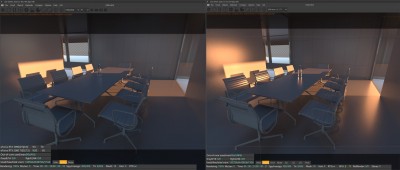

I recently needed to re-visit and old project for a client, I noticed it was rendering quite differently. (latest build 2020.2.3-R4)
I pinned it down to refractions not going through glass in the same way -- and discovered the nested dielectrics feature.
But, even though the different glass/specular materials aren't intersecting one another, toying around with priorities, and disabling nested dielectrics -- I can't get the same result as with the older version of Octane.
I wound up bouncing back to 2020.1.5 to get (what I think comes down to refractions?) to work the way they were.

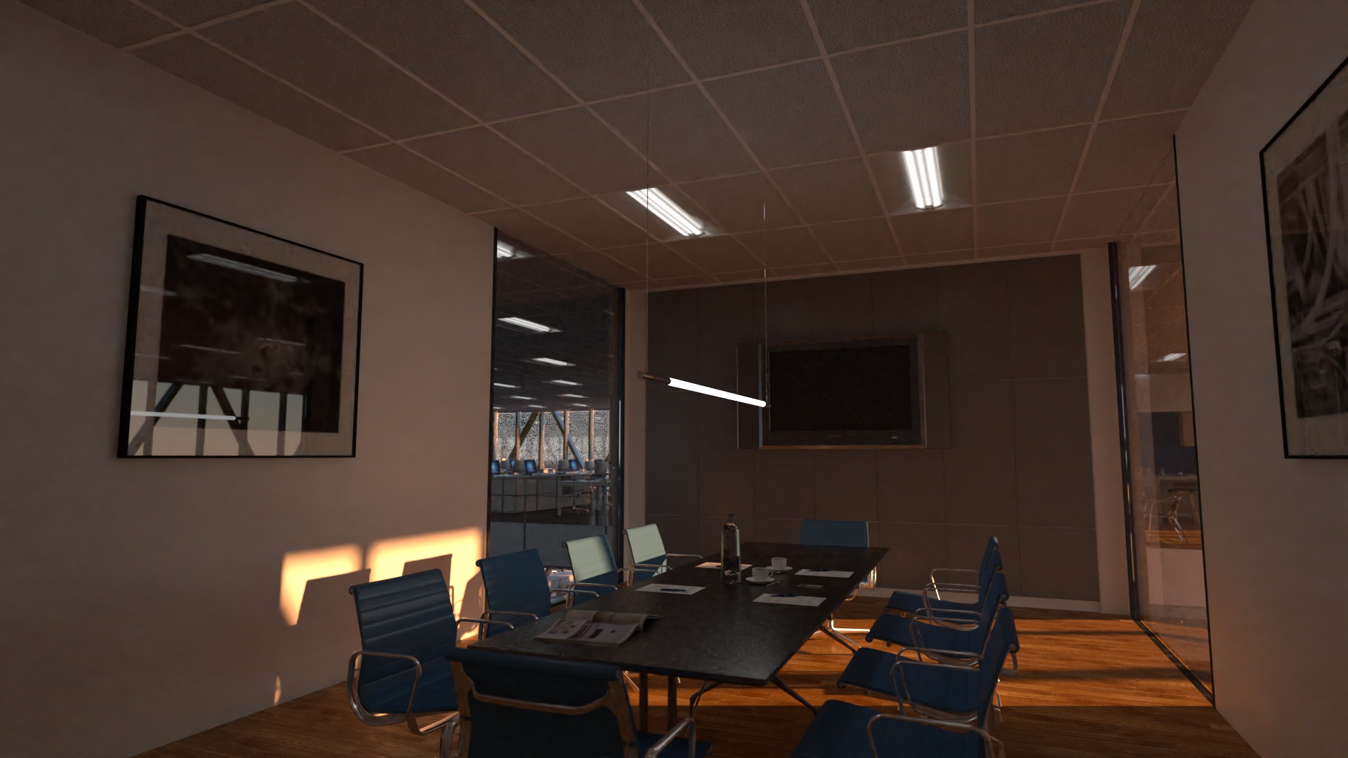

not getting refraction through glass as expected:

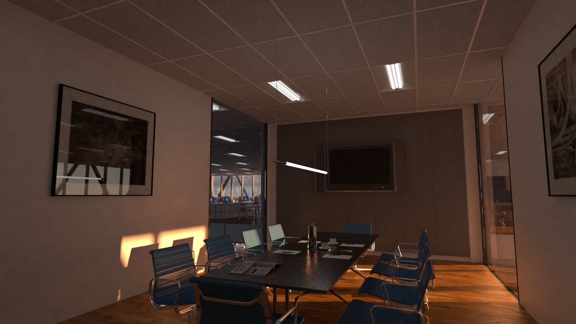

refraction reacting through glass as expected:
Thanks for any help you can provide!

Shouldn't unchecking 'nested dielectrics' revert to the 'old' way of things working?
The way light comes through from outside the window to bounce around the room isn't happening anymore (there's another room outside all sides)
The bottle and the window both have thickness - using a cloth object.
Even on the first series of windows on the outside of the building -- light doesn't seem to have ANY refraction that casts light on other surfaces.
The spots that show the most difference on these images specifically are: the bottle on the table, the floor in front of the right window, the chairs on the left side
Thanks!

I reduced this scene heavily to get it down to the bare essentials -- Dropbox File
Here is the comparison between how versions are rendering - I still can't quite figure out why the change is occurring.

Thanks for the scene, I have looked into this and it has nothing to do with nested dielectric, that's why it's still different compared to 2020.1.5.
What's happening here is we have fixed a long standing issue with caustics and fake shadow, the highlight below the glass window is not actually supposed to be there as the window has should have 0 roughness, so there should be no caustic blurring when the ray hits the glass and onto the floor.
