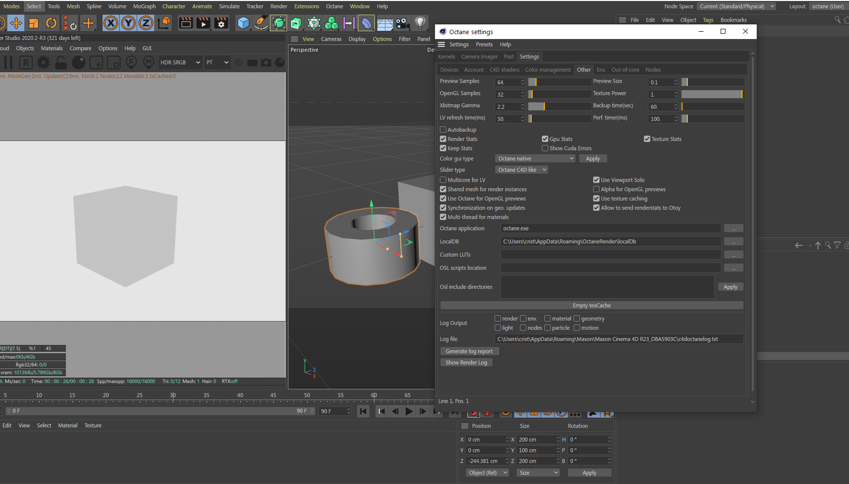

Some weird stuff happening here. Suddenly live viewer stop working fine. It doesn't update position or when you add another object to scene but it updates material and camera movement... And it works a little slow.
I attach a video.

Your geometry update icon in Live Viewer that is disabled, enable it.
