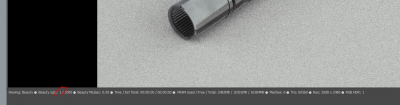

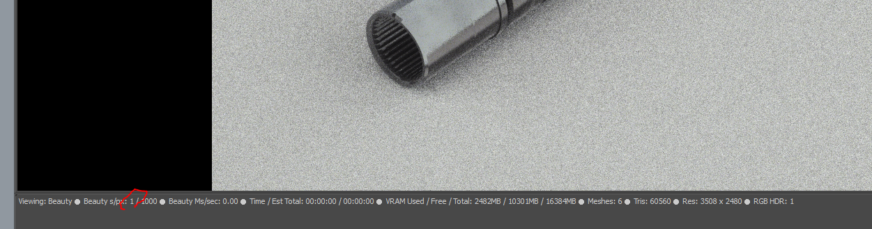

I just tried to follow your steps in case to make ACES work, but failed:
I have a MODO 14.2v2 and latest Octane build installed (2020.2.3.171). My render is hanging at the first sample if I going to use OCIO view with "ACES:sRGB" or any other from the long list there, except "none:sRGB". Right after I set it back to "none:sRGB" everything is run smoothly.
