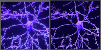

I have been having trouble getting bloom power to show up in my renders. It shows up if I include a backgound in the render, but I can't seem to get it to appear on any transparent image. Does anyone have ideas as to how to fix this? Here is an example of bloom with bg vs without (same render, no setings changed except to render alpha) I have tried every variant I can think of, including multilayer files.

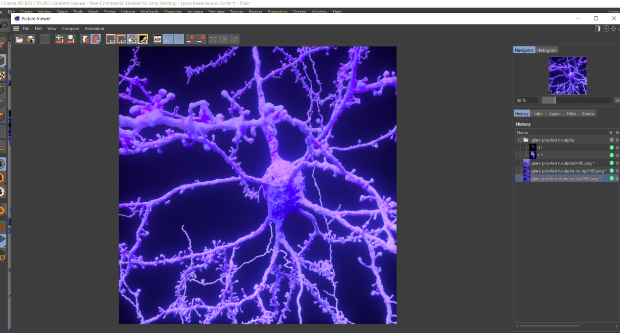

It may be worth noting that the blur shows up in picture viewer, but when I bring the image into .ai it is gone.

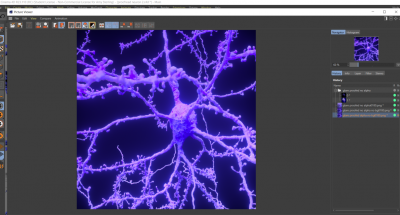

picture viewer showing blur on file that does not actually have blur when opened in another program

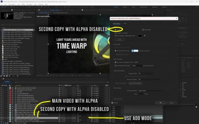

There's another method which avoids extra files. If youre making an animation then just import the footage into after effects twice, once with interpretation set to use the alpha and once with it disabled. The glow data is in the colour channel of the render, the alpha channel is just cutting it away. You can stack the version with no alpha behind with mix mode set to add. This way you get your main crisp top render with alpha channel plus an un-cut version below acting as the glow.
The same is possible in PS but theres more steps involved.
