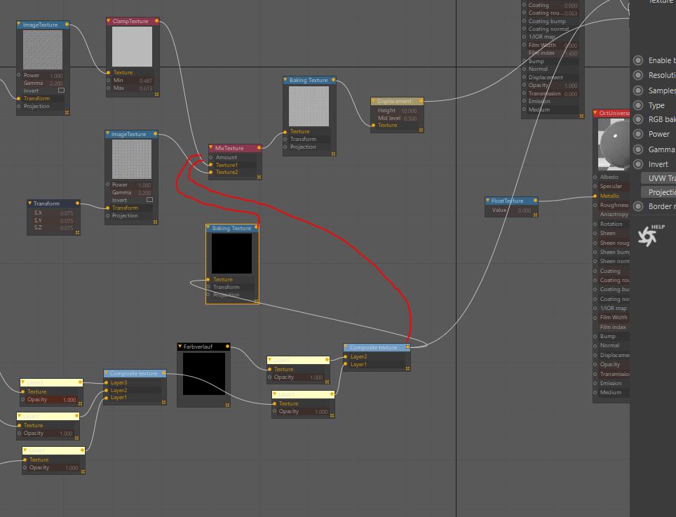

i have a Mix Material and a composited Mask to mix it. If i use this Mask for a Mix Node to mix the the displacements as well, Octane crashed.
WIN10, GPU 2 x 2080ti, 32GB RAM, Driver 461.72, Plugin C4D 2020.2.3-R3
If you wanna try it just connect the nodes like the Screenshot (only one ;)) already tried to bake it.
Its strange to me cause it work with the mix material but not for the mix node.
Thank you

have you tried with Vertex Displacement without Baking texture, instead of Texture Displacement + Baking texture?
https://docs.otoy.com/cinema4d/OSLVerte ... ement.html
For complex Displacement effects, it is far more stable and productive.
It can be used with both procedural, and texture image types, it does not have any projection limitation, so you can use the Border Mode to remove the Tiling effect, for example, it does not depends from image resolution and depth, but only in the number of subdivisions, and you can mix together any type of nodes and plug in it directly without need to use the Baking Texture node. Finally, it works correctly with Motion Blur, and it accelerated by RTX!

yes it is set to Vertex Displacement.
The composited Mask works for the Mix Material but not for Mix Material Node. If i connect it to the Mix Material node octane crash.
Check the file.
Crash Log is in zip.
Posts: 16068
Location: Türkiye
It's reproductable, but couldn't find yet the reason. Most likely about previews, also prefer to use composite material anymore. Mix materials are not safe as this.

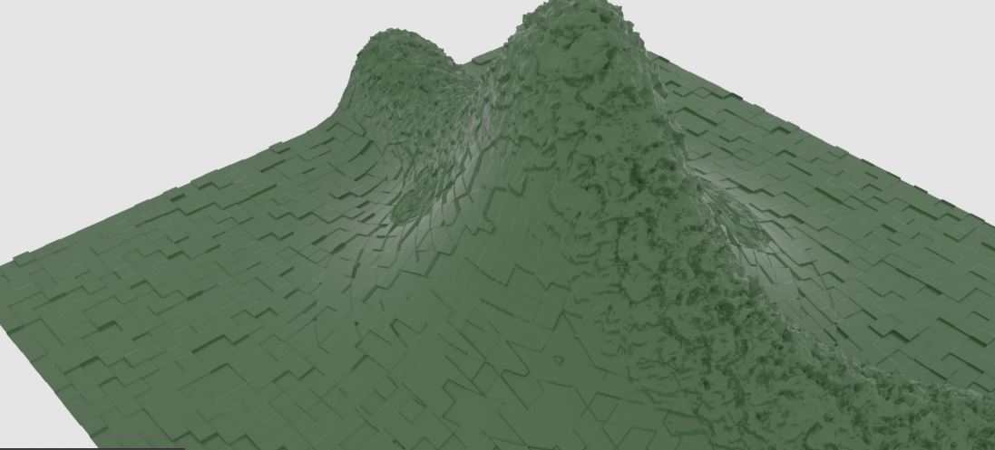

I use the Plugin terraform4d https://www.terraform4d.com/ this Plugin has a operator shader wich is very usefull for blending textures and also displacement. unfortunately i have some issues if i use it (thats why i tried to use manual created masks)
here you can see a test setup. do you see the issue? the displacement is mixed with the shader of terraform4d (round lines in mountain). Some guys told me the issue could be that the operator shader is not baked in 32bit? could that be possible?
regards christian
Posts: 16068
Location: Türkiye
hazenkind wrote: here you can see a test setup. do you see the issue? the displacement is mixed with the shader of terraform4d (round lines in mountain). Some guys told me the issue could be that the operator shader is not baked in 32bit? could that be possible?
regards christian
Talking about grebble effect? 16/32 bit with gamma=1 is a must but this is having like an extra problem.
