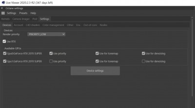

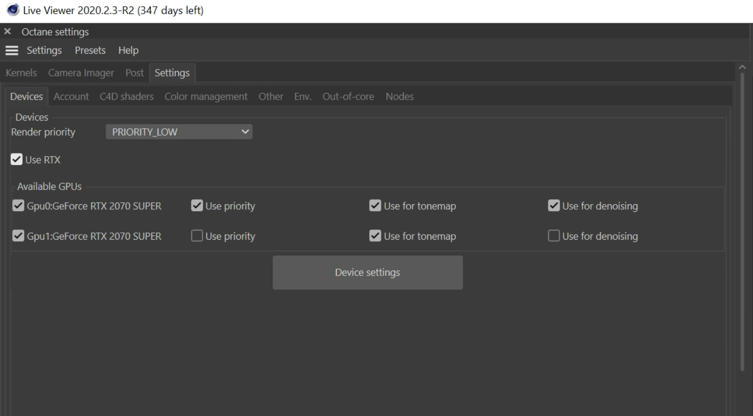

Then please go to c4doctane Settings/Devices panel, and make sure that RTX 2070 is enabled.

When I open my Octane settings, I see my graphic card but everytime I select it octane automaticaly deselect it.
