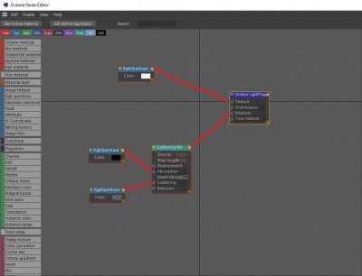

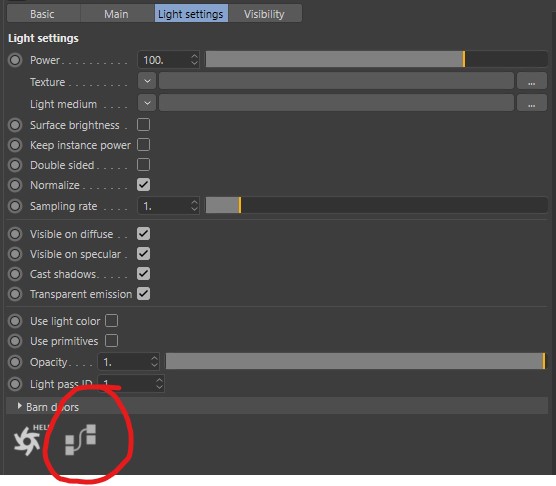

1. Open the node editor by clicking the node icon at the bottom of the light tag settings (pic 1) 2. Reconnect the nodes that should have been connected properly when we create the Spotlight object (pic 2) J.
It would be fixed if somebody warn me about it until now! It's an overlook on creation method after changing some lines. Fixed for R4.
