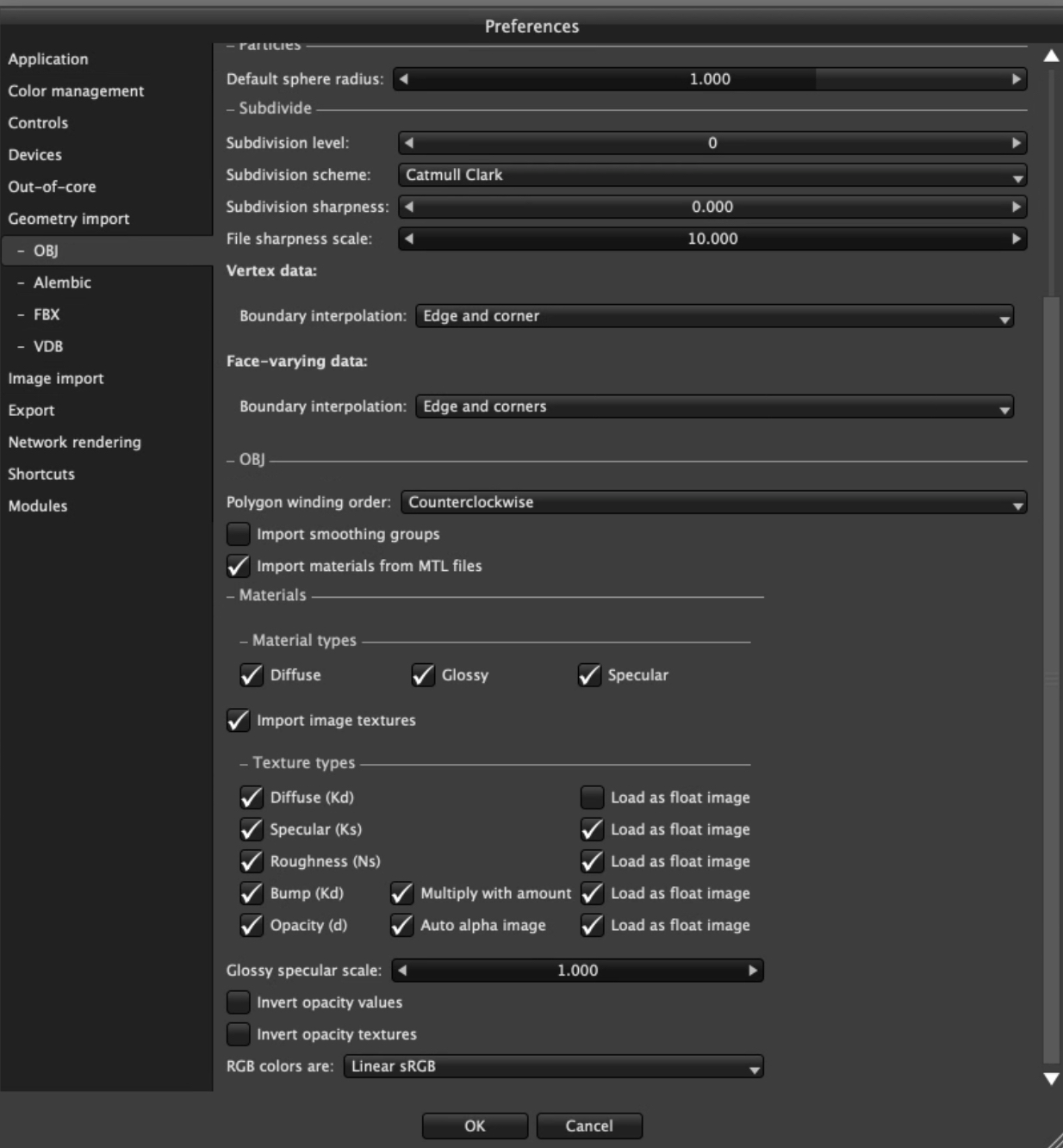

sorry, I’m not used to use FBX with Standalone, but please go to OctaneX menu, Preferences/Geometry Import/OBJ: There are some options for materials and textures, and you can also correct the .mtl file that come with .obj with a word processor, if necessary.

Thank you for your answer, but no luck yet.
Checked preferences and everything seems ok, OBJ does import geometry but materials come all white, no values nor images. Also, for OBJ I don't get the dialog stating issues, it just imports, no difference between shaders, all the same and trace of where image maps where used (no nodes for bump for example).
