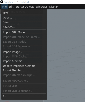

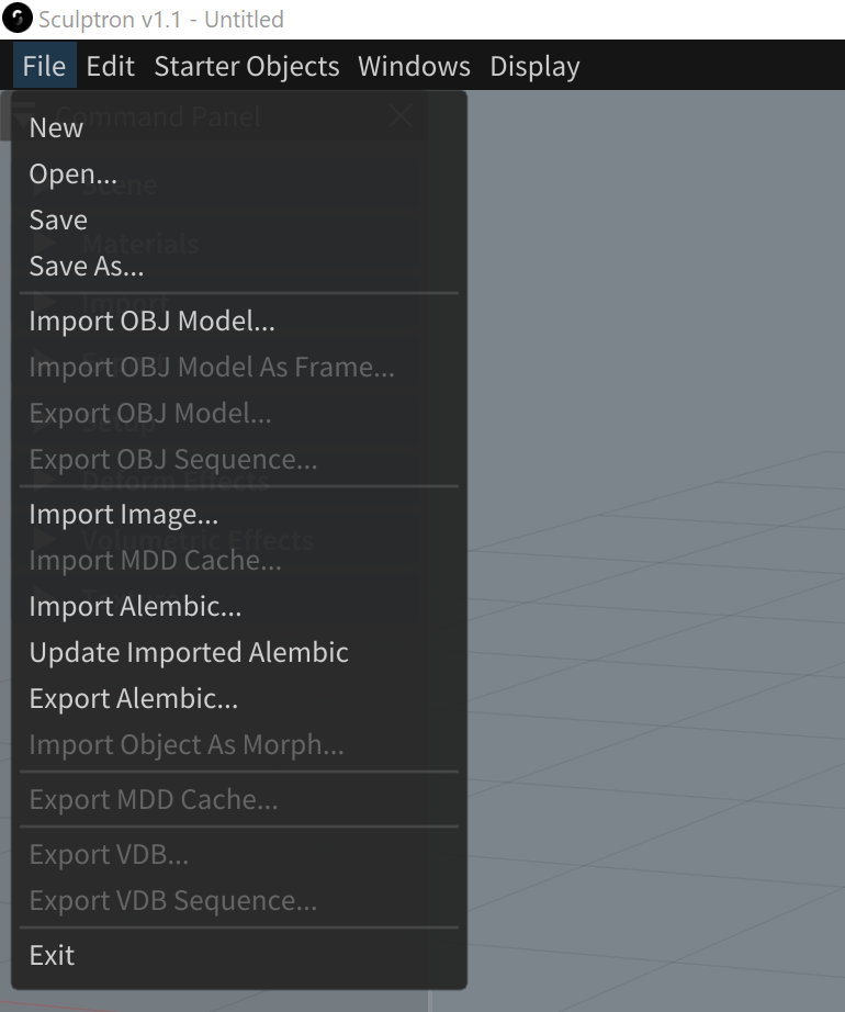

You can find the new Import Alembic option in the File Menu:
Import Alembic
Use this option to import an Alembic file. Only meshes with fixed topology are supported right now (deforming characters and animated, undeformed meshes are working great, fluid simulations are not supported).
Curve primitives are not supported yet.
Update Imported Alembic
Any change to the Alembic cache can be exported using this option. A new Alembic file will be generated, while the original one will be preserved. The "Copy_out" string will be added to the original file name.
Sculptron will only update the animated cache information in the file, preserving the original geometry.
Export Alembic
This option can be used to export an animation created in Sculptron directly. At least a Sculpt Layer must be added to the mesh for animation to be exported.

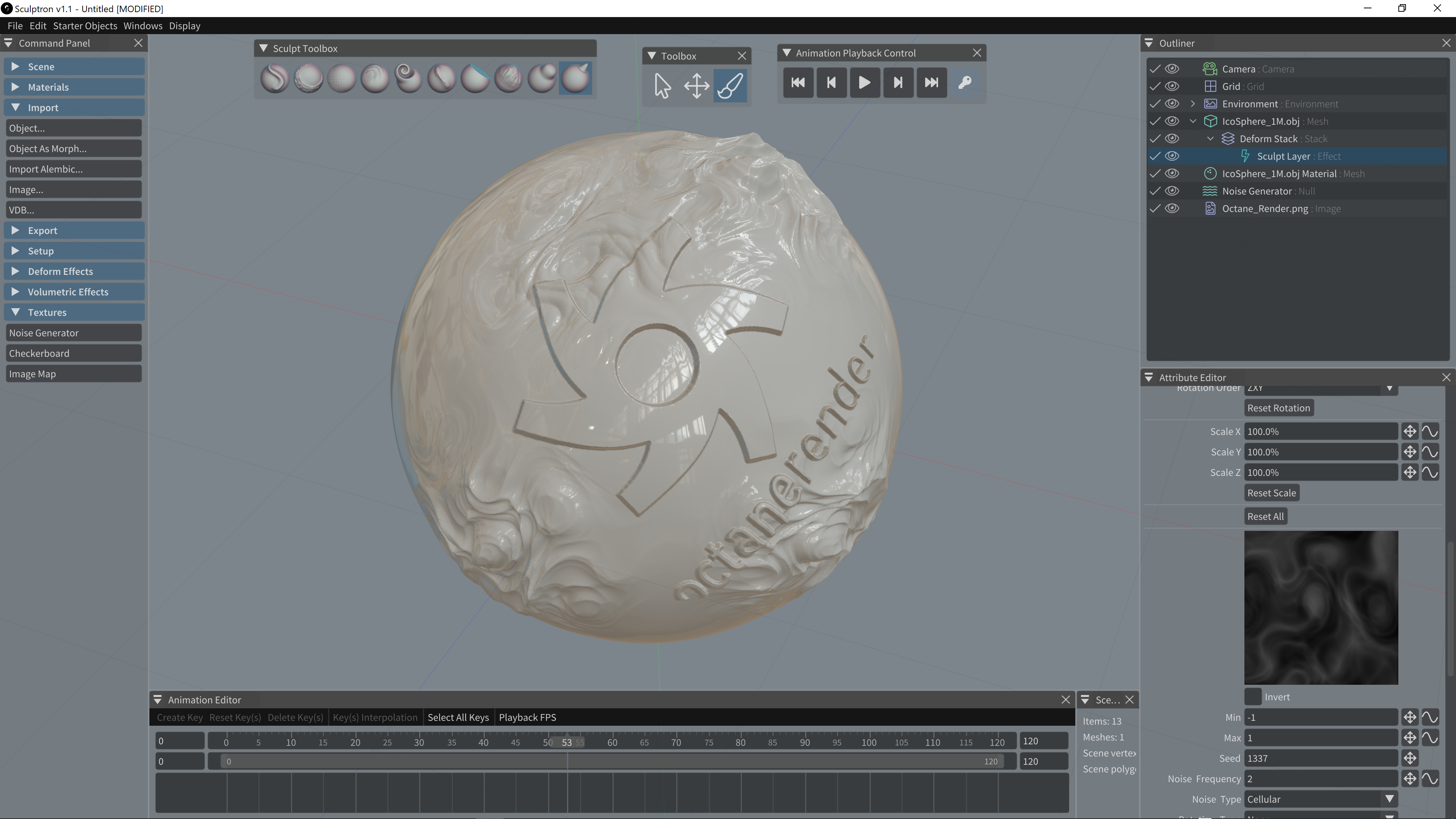

Procedural and Texture Images can be used directly as Alpha now.
There's no longer need to use an Image Map item to sculpt a mesh using an Alpha. Noise generator and loaded texture images can be dragged directly into the Texture slot of the Sculpt Layer Effect. Also, it's now possible to assign different alphas to each brush tool.

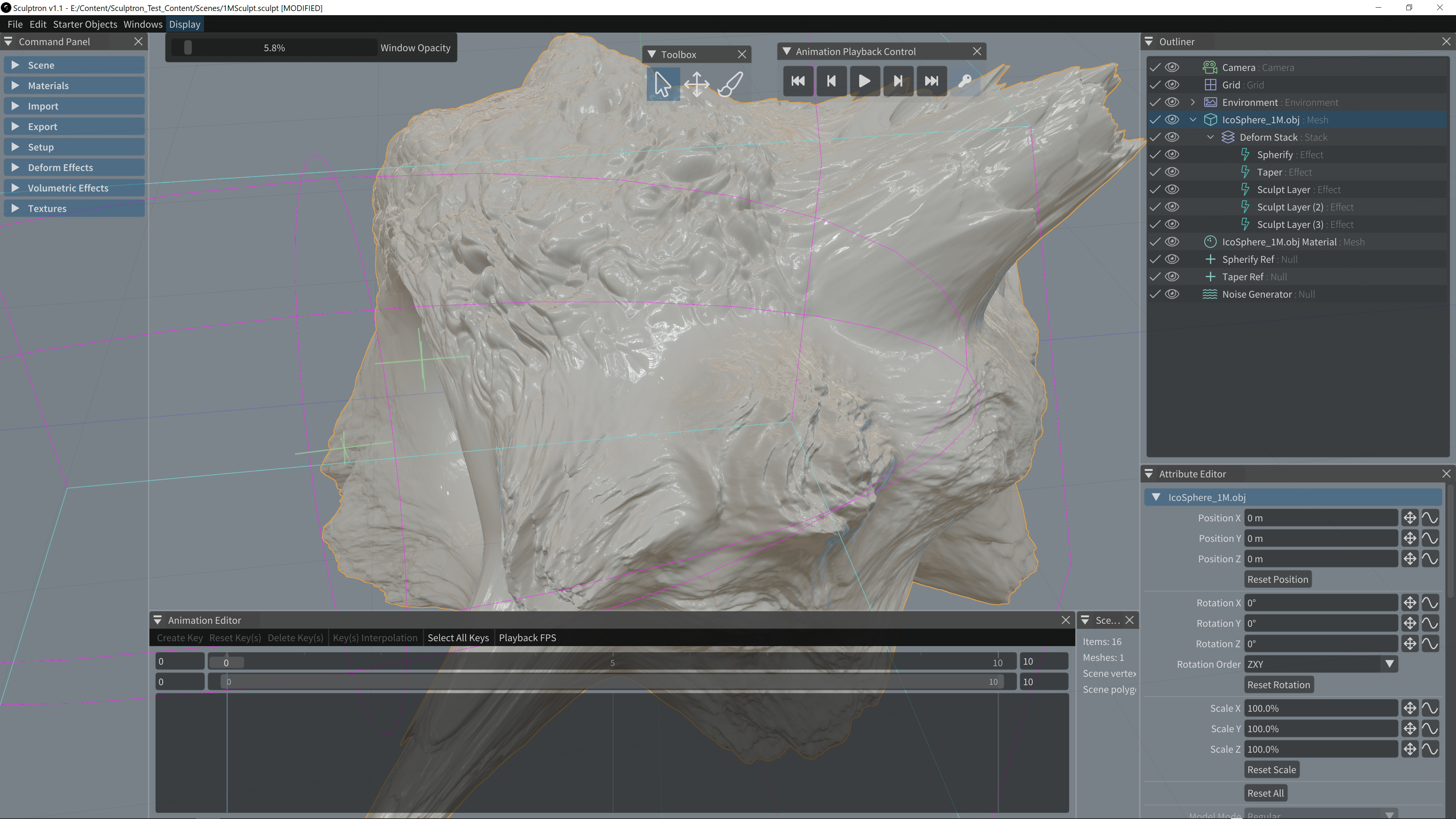

Windows Opacity Option.
A new option allows to set the general UI opacity.
