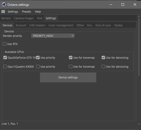

Im using a 1070 and a k4000. But the k4000 isnt enabled in octane. see screenshot? its disabled. I use the k4000 for my second monitor only and disable it for octane.
Ok, please upgrade to 2020.2.3-R2, and make sure to have a Nvidia driver greater than 456.38.
Please, also download and run GPU-Z:
https://www.techpowerup.com/gpuz/
And share a screenshot from the Graphics Card tab, for all the available Nvidia GPUs, thanks:
You also need to download and install 2020.2.3 Standalone.
You can find it by visiting your personal Downloads area:
https://render.otoy.com/account/download_archive.php
At first start, you will be asked to press the Download button, to automatically install a new cuDNN library to run it correctly:
ciao Beppe
