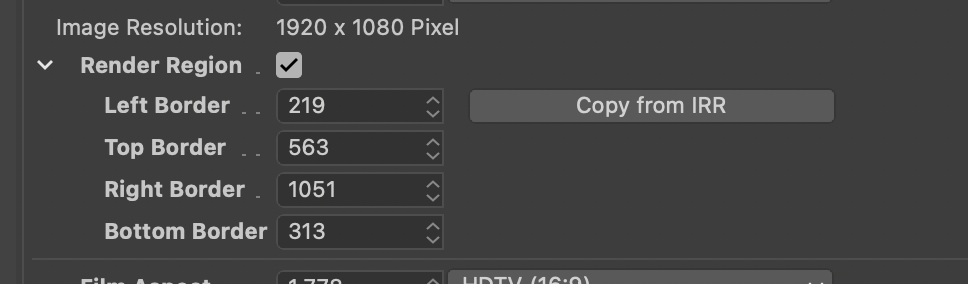

Hi, I wondered where the Get last render region from LV had gone?
I can only see a Copy from IRR button which has no affect when rendering
Copy from IRR
Copy from IRR

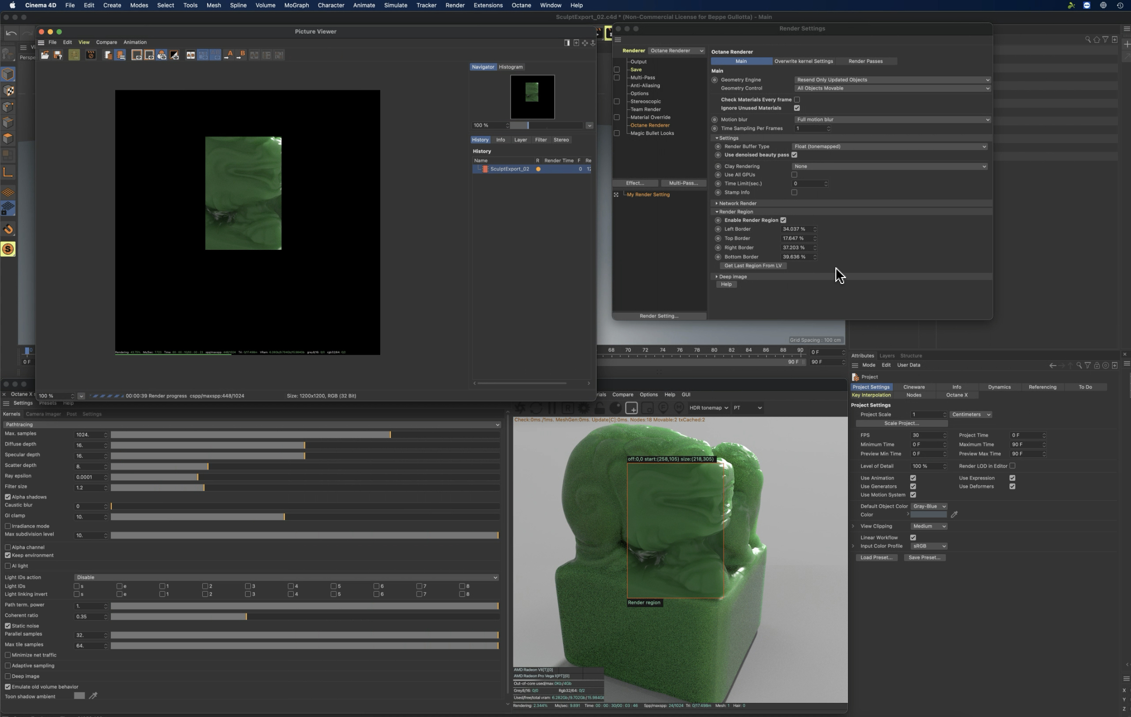

Posts: 10621
Weird, the borders should be set as percentage, not pixels :roll:
Here it is working as expected in PR11:
ciao Beppe

ok I was looking in Render Settings>Output>Render Region: Copy From IRR
and instead I should be looking in Settings>Octane Renderer>Enable Render Region: Get last region from LV
