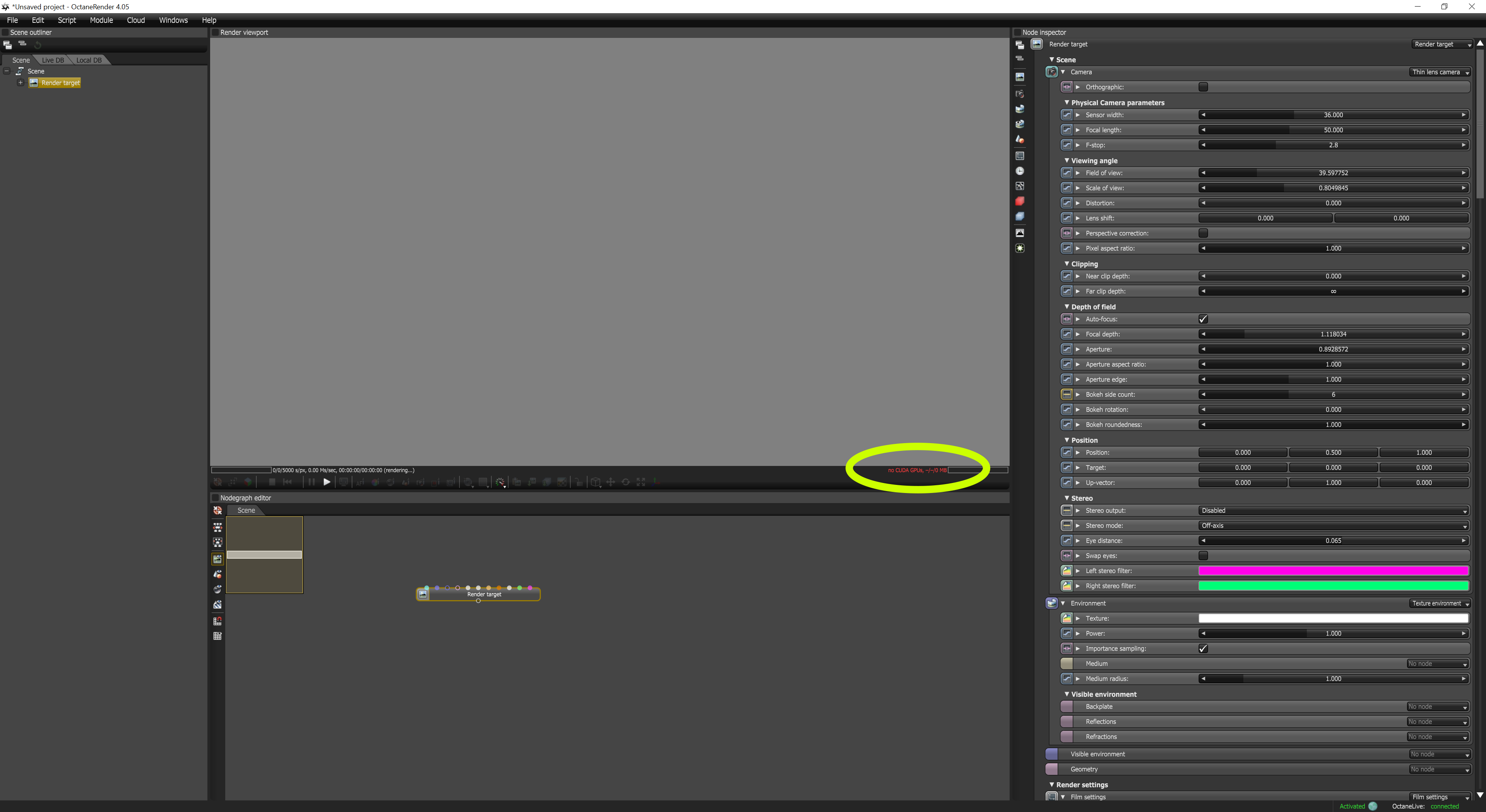

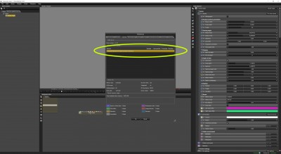

Hello everyone, recently I've installed octane in a new computer, with a processor AMD 5900 and a GPU Nvidia Georforce RTX 3090. I'm running Octane stand alone ver 4.04. When I launch the software I get nothing on my viewer, but a small message on red at the lower right corner "No CUDA GPUs", when I open File/Preferences/Devices the video card is there selected in yellow, but nothing happens. Just did a clean install of the latest drivers but it didn't help. Does anybody has any thoughts? thanks!

Tripiox wrote:Hello everyone, recently I've installed octane in a new computer, with a processor AMD 5900 and a GPU Nvidia Georforce RTX 3090. I'm running Octane stand alone ver 4.04. When I launch the software I get nothing on my viewer, but a small message on red at the lower right corner "No CUDA GPUs", when I open File/Preferences/Devices the video card is there selected in yellow, but nothing happens. Just did a clean install of the latest drivers but it didn't help. Does anybody has any thoughts? thanks!
RTX cards are not supported in version 4. You'll need to upgrade to the latest version to use your GPU
