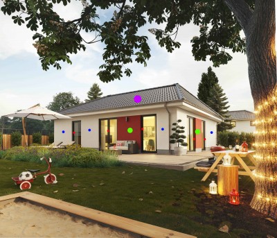

Independently change the color of these areas that I have marked with circles

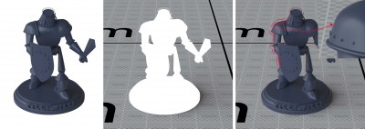

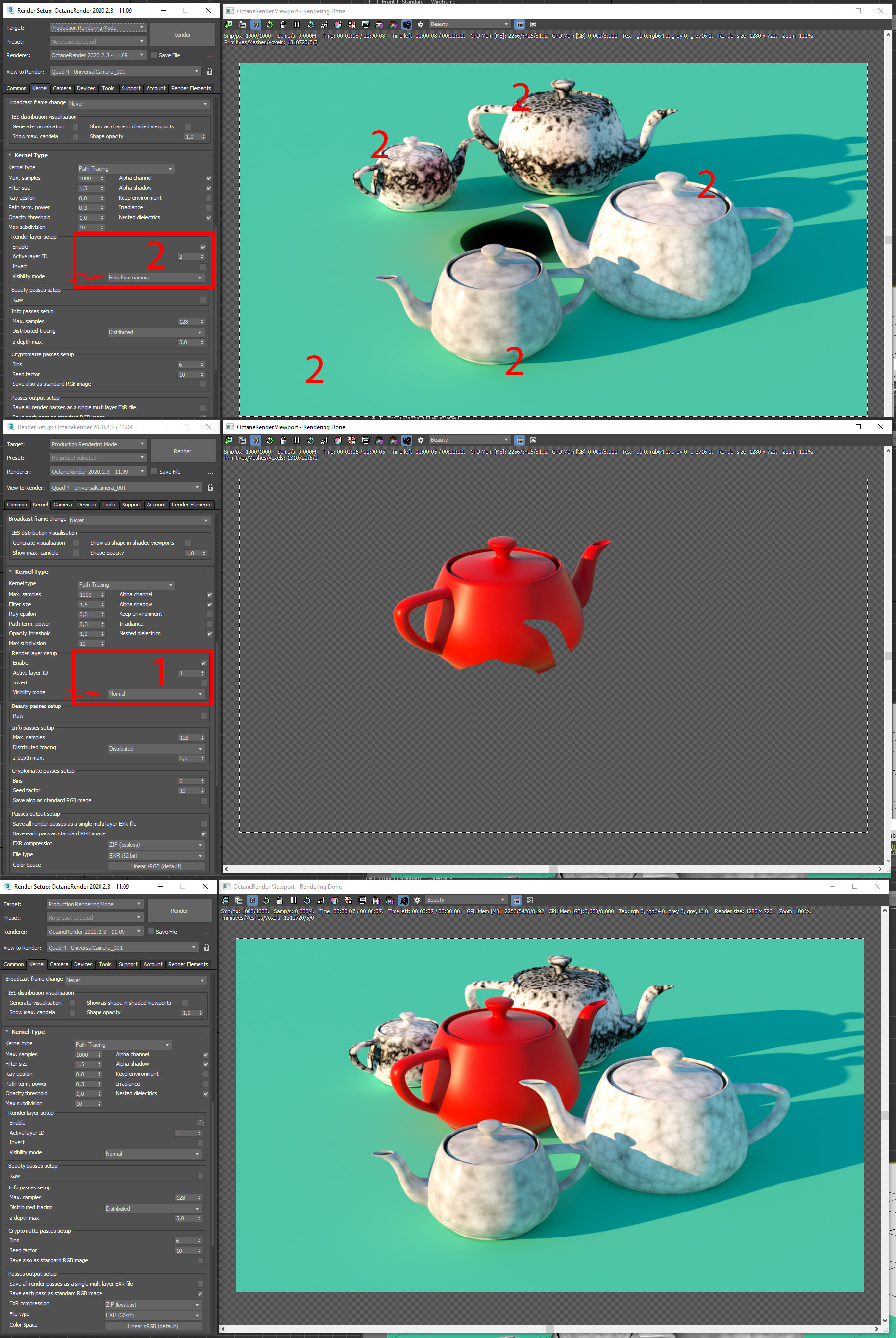

Hi samsue,
personally, in this case, I would use the render layer ID. In this way the changes of materials and colors will be consistent with the scene and the render time shorter.

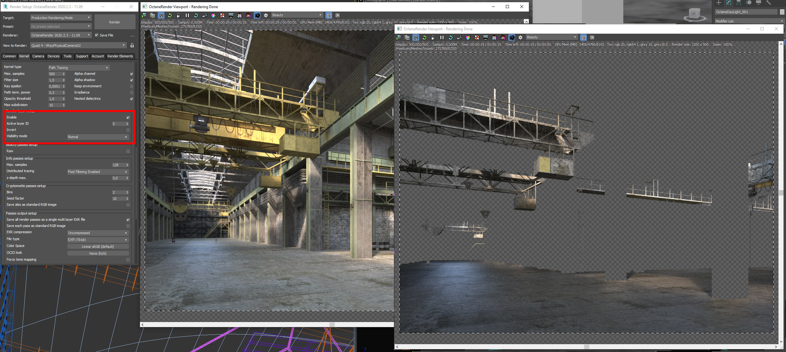

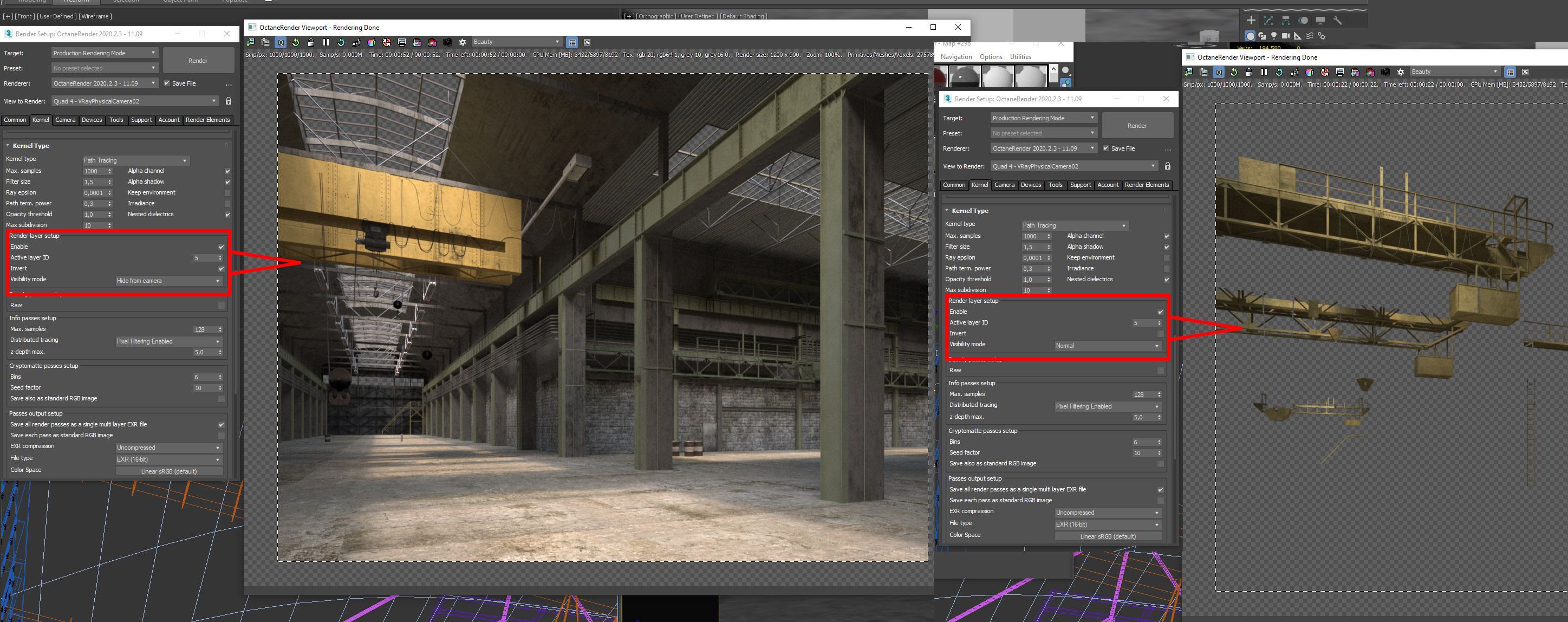

do you know how I can solve the semi-transparent border? I mean when you render the image in parts using ID you have this border that becomes transparent between layers.
paride4331
Posts: 3998
Hi samsue,
I hope I have understood correctly.

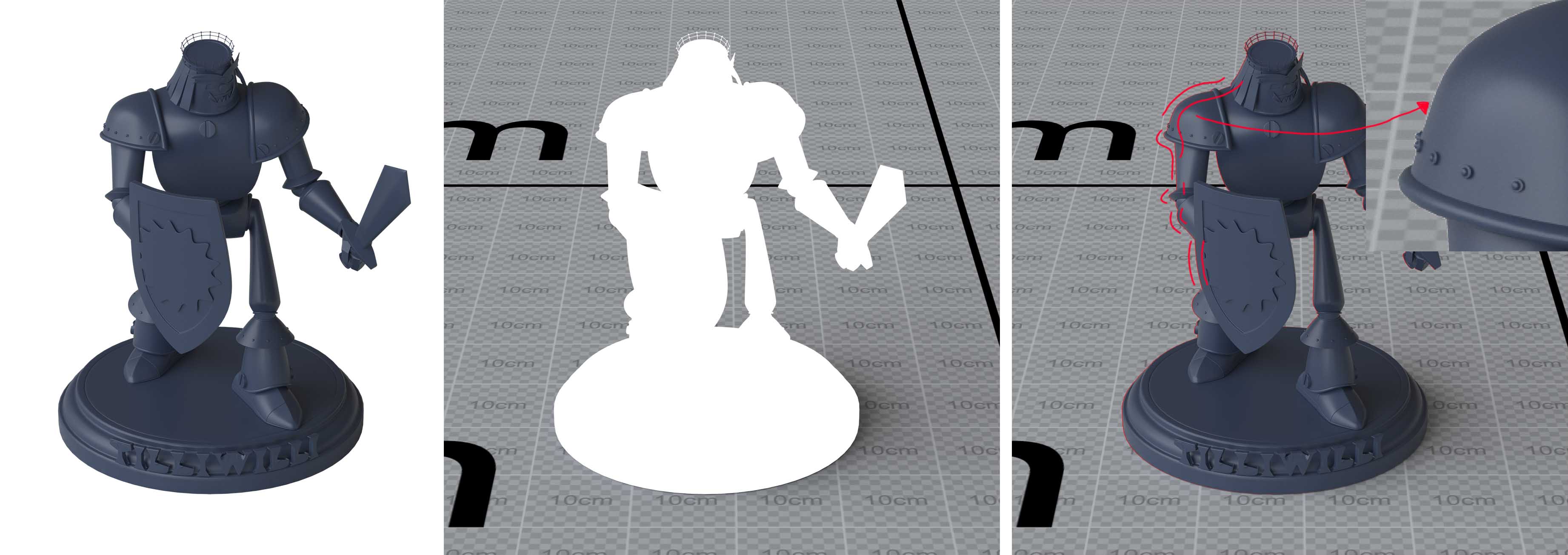

i mean this line
paride4331
Posts: 3998
Hi samsue,
samsue
Posts: 393
how stupid I am! Thanks Paride
