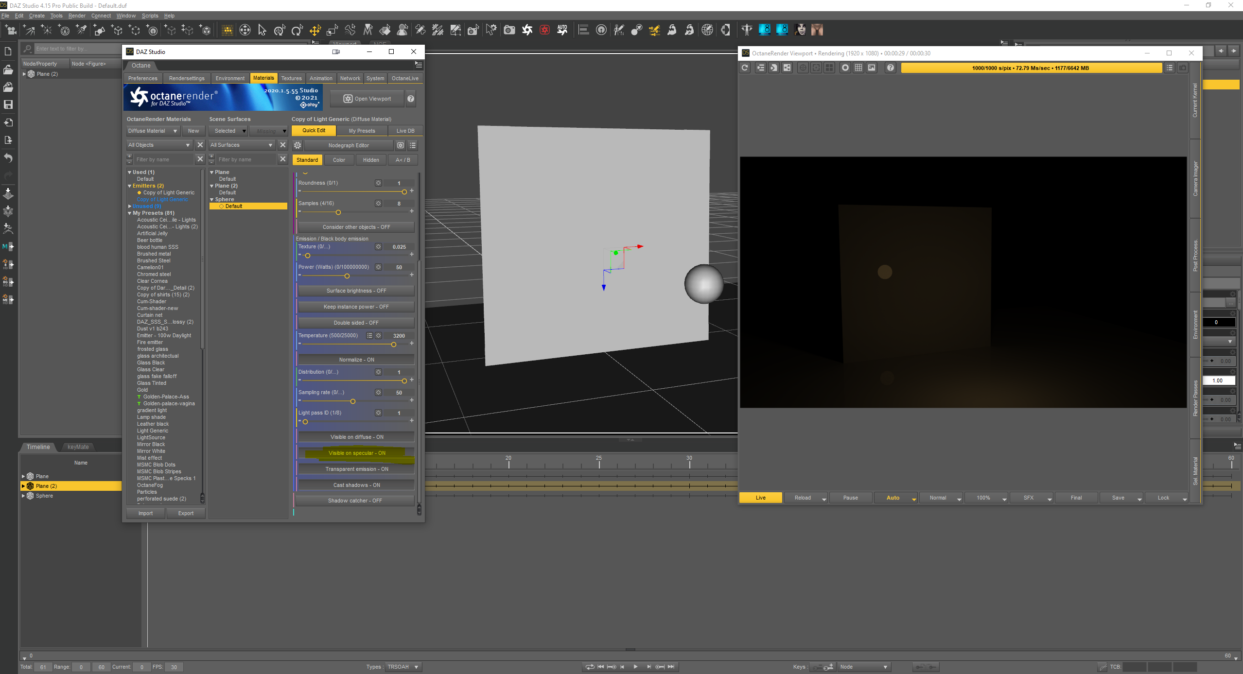

Hi, I've been trying to find how to remove the emitter mesh from the reflections on the render and I don't find the solution.
In the object parameters, I turned off visibility control and camera visibility which according to otoy this should remove the mesh emitter from the reflections.
What am I doing wrong here cause the mesh still appears in the reflections
Thank you
https://imgur.com/a/dKsKRqX

I don't think you can because of the nature of path tracing. Some things to consider when concealing the light source:
  • Try moving the light source so its not visible from the camera's perspective
  • Use a IES for the distribution value (set to grey image and drop down to Octane IES) on texture emission/blackbody node, this can give you spot light effect so you can laser in on a target from a distance
  • Set the mirror to a different render layer so you can render it separately later, perhaps with a substitute light source that isn't visible to the camera
In some cases getting the lighting you want will require post work, such as the use of render layers that you can composite in a photo editor.

You just need to turn off Visible on Specular then it will not show up in glass, mirrors or any reflective surfaces
you still need to hide it with Opacity also

I've tried many of the things you guys mention here, but here is the problem, sometimes it's impossible to have an angle that the reflection won't coincide with the mesh being reflected, the same thing applies with ies. For example, I use a sphere with light bulb specific ies and circular distribuition projection to normal space(ies lights), the sphere is still being rendered has a light in the reflection.
Setting the mirror in another layer is a workaround that only works sometimes, but in the end, if you are bound to render in that angle eventually u will have to render to the reflective surface, for example, if you are rendering a subway interior, the car is full of glasses all around and you end up having to render the glass and the reflection of the mesh.
Removing the specularity is not something I desire to do.
My whole point of asking this is because, in other Octane plugins like c4d, you hide the geometry from being rendered and still keep the specularity, I was hoping this was something I was not doing correctly but at this point, it seems to be rather a bug more than anything else.
oh well...
Thank you guys
