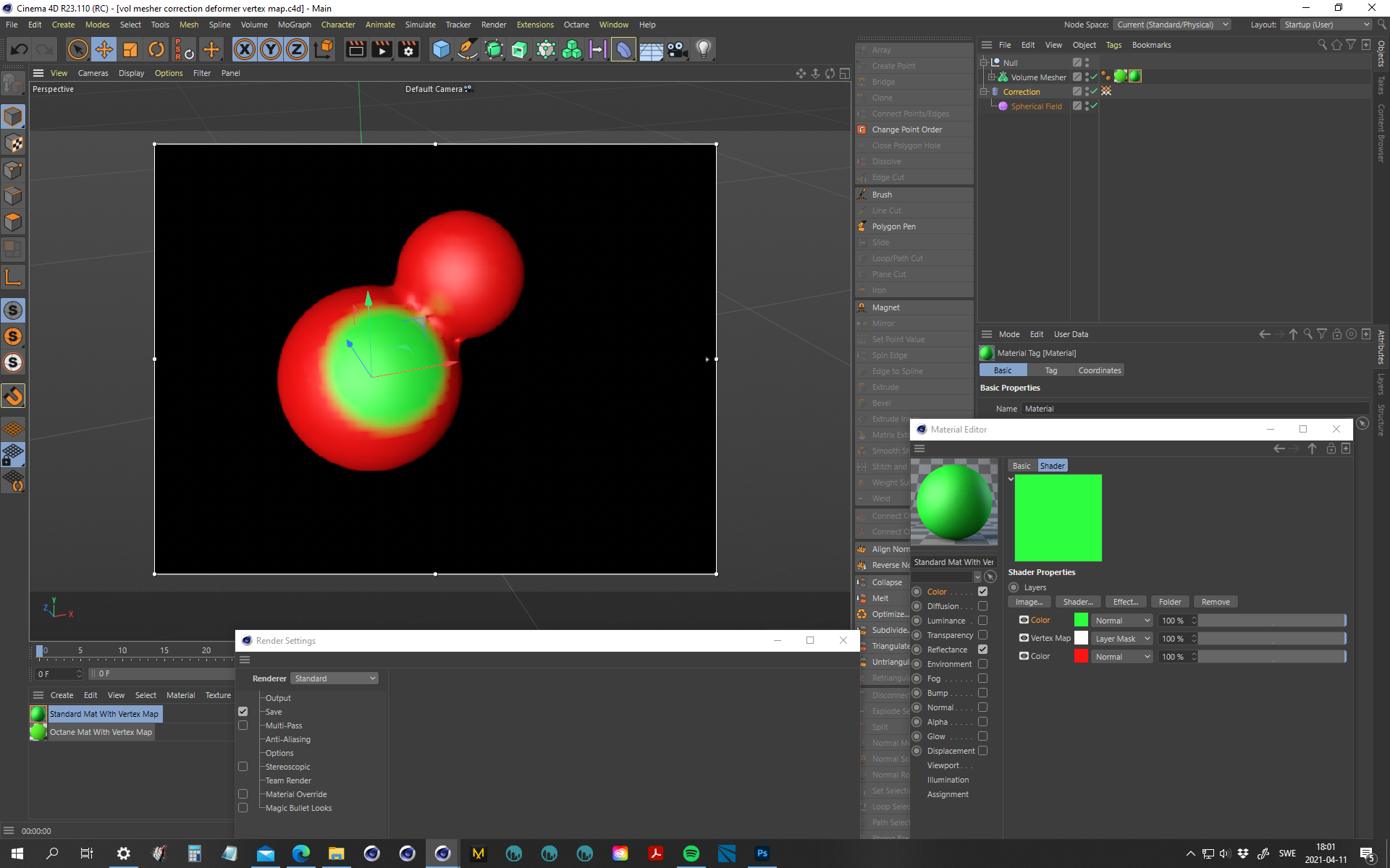

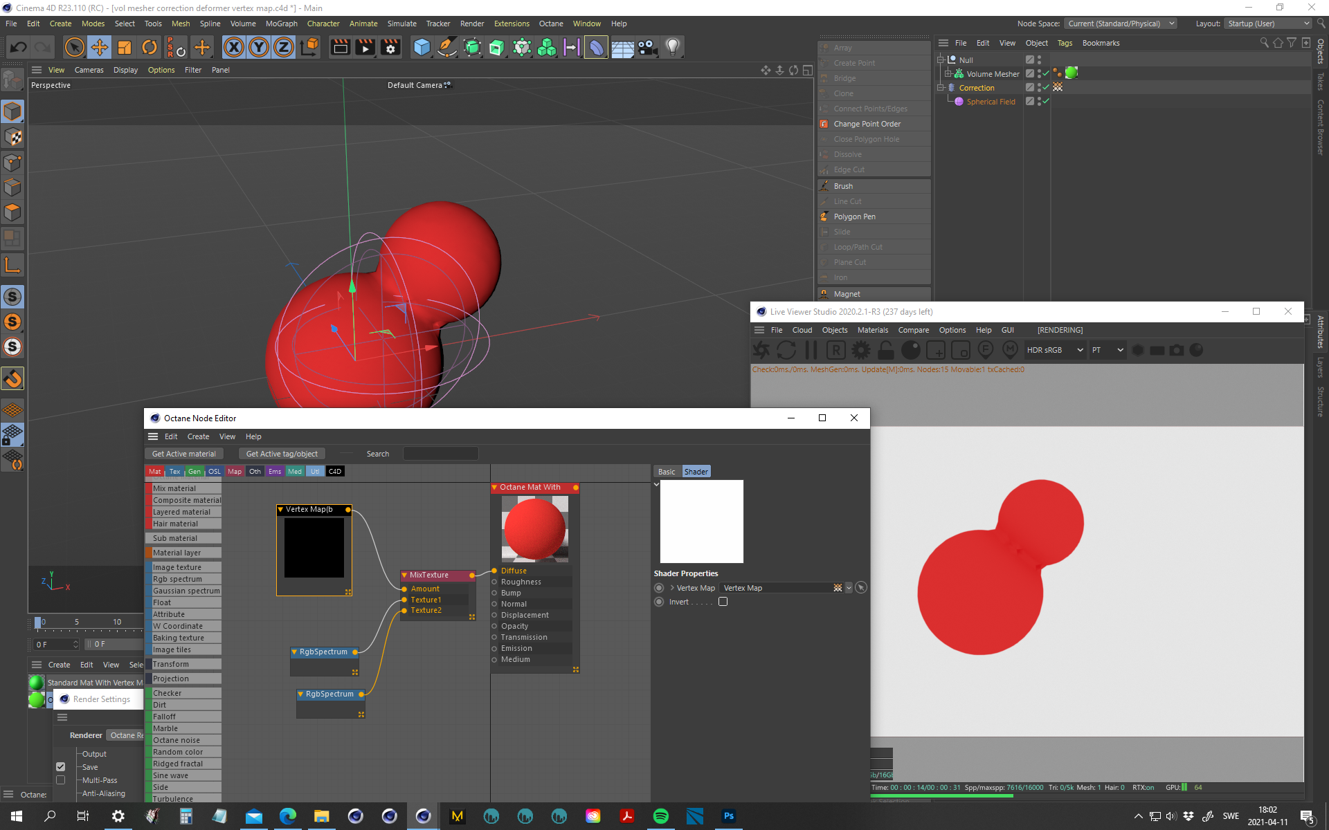

I have been testing ways to create vertex maps on objects generated from the Volume Mesher, to use as material masks, by using the Correction Deformer which can output a vertex map (I used a spherical field) and it works when creating a standard C4D material, but I can't seem to recreate the effect with Octane. I'm not sure if I'm missing something.
Attaching a C4D file as an example and a pair of screenshots as well.
Would be great to get some insight into this, so any help would be very appreciated.

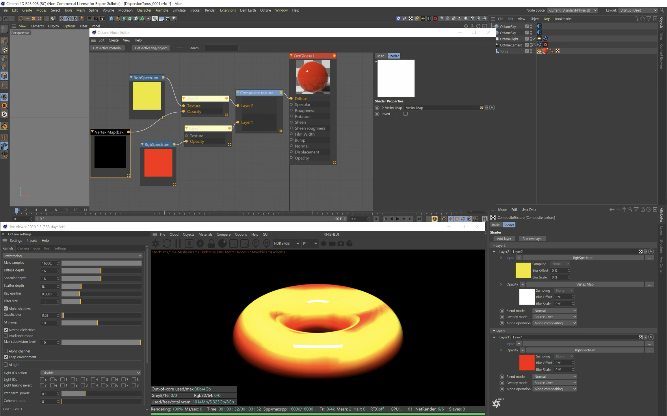

In 2020.2 there is a new Composite texture node for this:
ciao Beppe

Thank you for the reply Beppe, but I see that I was not clear enough. :)
Let me rephrase:
I'm aware that the Layer Shader is not supported, it was only included for demonstration purposes.
Here's scenario with the actual problem:
1. I generate a vertex map onto the still active Volume Mesher by utilizing the Correction Deformer which can output a vertex map.
2. That vertex map does work when using it in the Layer Shader in a standard C4D material, as demonstrated in the file.
3. That same vertex map does not appear to be read correctly by Octane though, as can be seen in the Octane material in the provided C4D file, where it is used to control the Amount in the Mix node, but does not work.
So, I'm wondering where things go wrong here.
Regards
Andreas

I looked at your scene, I'm not sure how vertexmap tag transfers data or connects the values to mesher? The current implementation is supporting the vertexmap tags which are assigned to mesh objects.
AWOLism
Posts: 96
Joined: Thu Aug 30, 2018 12:10 pm
aoktar wrote:I looked at your scene, I'm not sure how vertexmap tag transfers data or connects the values to mesher? The current implementation is supporting the vertexmap tags which are assigned to mesh objects.
Thanks for the reply.
Yeah, I can't really answer that I'm afraid. I have been trying to find ways to generate vertex maps on Generator Objects in C4D, and found this link:
https://forums.cgsociety.org/t/anyway-t ... me/2050267
But as you say it does not appear to transfer to Octane.
Are you aware of any other solutions to create vertex maps on Volume Meshers, or even on an Alembic?
My goal is to be able to better control texturing of animated objects with varying vertex count, and vertex maps controlled with fields seems like an ideal way.
