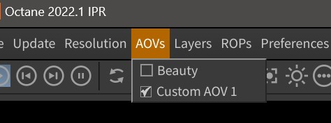

Actually there is a way for this.
Here are the steps:
1- Use the "Capture to Custom" inside Octane Material Builder network.
2- Plug the input texture you want to SOLO to that node and select which Custom AOV# you want to use.
3- Enable the Custom AOV# in the "Render Target" node.
4- From the IPR "AOVs" menu select the Custom AOV#
*It's a bit harder than Cinema4D but it does the job until someone makes a faster solution.
