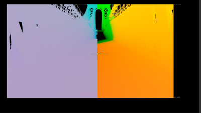

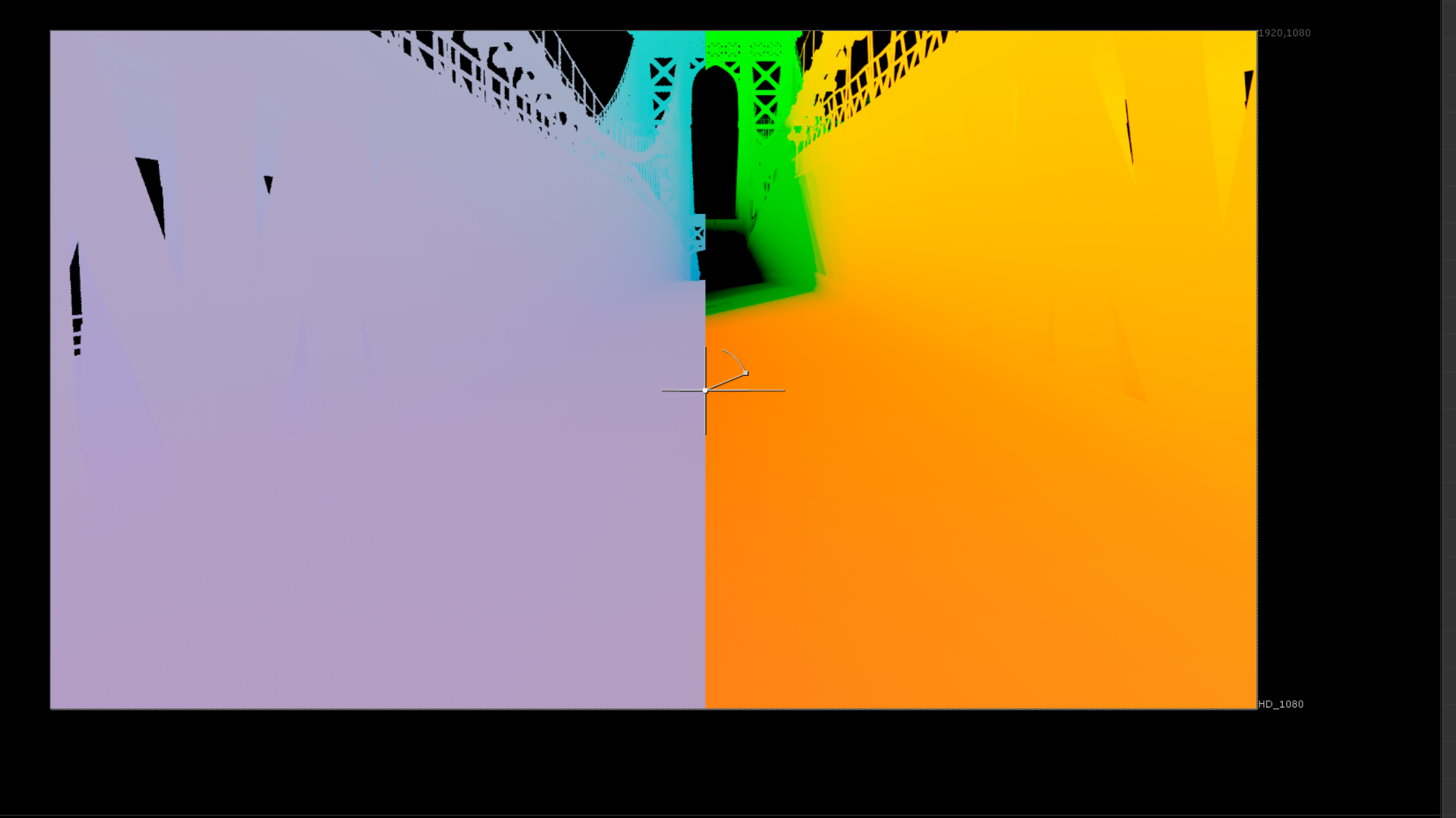

I need a world position to relight in nuke, I've tried the position AOV, but it seems it's not world position ??? It doesn't work with nuke ?
On the left part the position AOV from octane on the right the wrold position from redshift, so no world position AOV in Octane ?
No World position AOV ?

I think that the problem can be that Octane doesn't have the same coordinate system. Have you tried to invert the Z coordinate in Nuke inverting the latest color component? Probably this will match the colors from both renderers.
Thanks,
-Juanjo

Ok thanks Juanjojuanjgon wrote:I think that the problem can be that Octane doesn't have the same coordinate system. Have you tried to invert the Z coordinate in Nuke inverting the latest color component? Probably this will match the colors from both renderers.
Thanks,
-Juanjo
