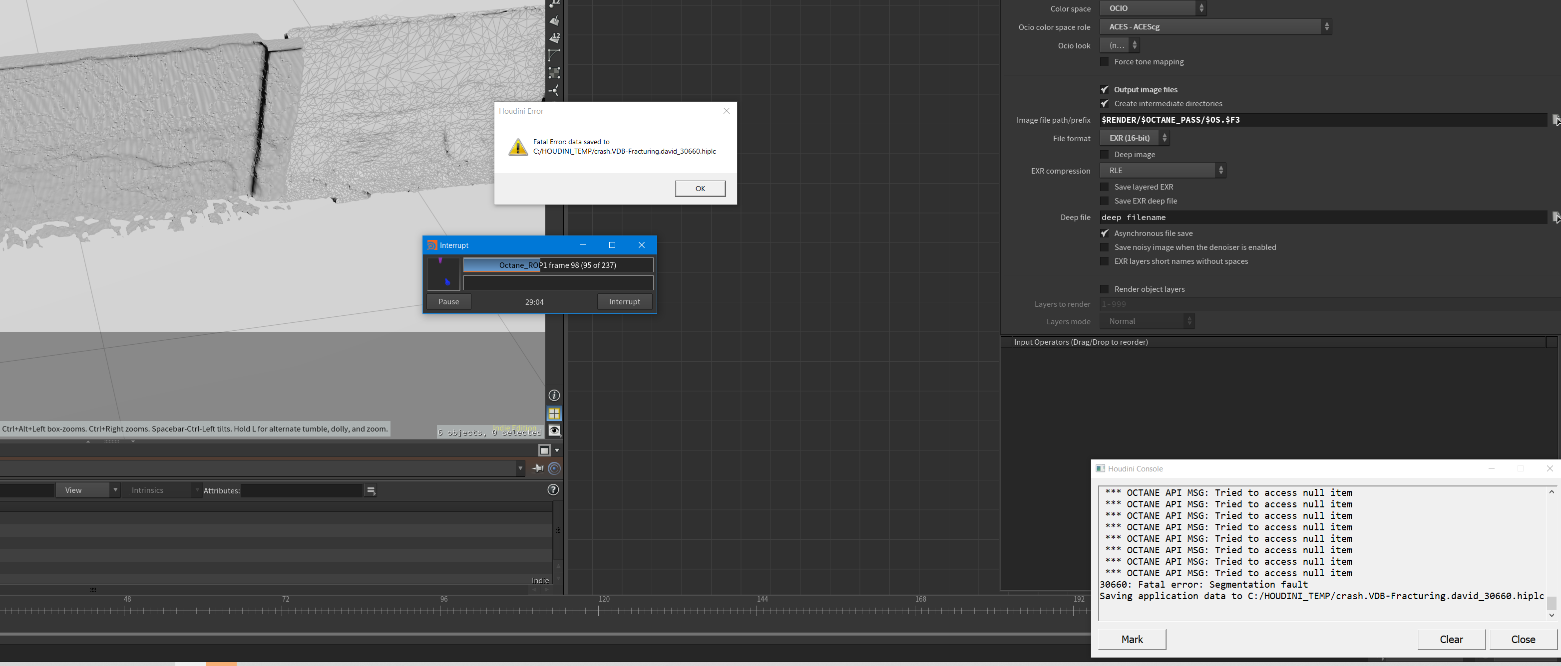

I'm trying to render a simple animation, but each time randomly all crashes :/ (for all render 6 crashes ... )
And here is my scene https://www.dropbox.com/t/8rW5PJZrVcKcxTRP
Hopefully it's fast with my 3090 but 6 crashes for a render ....
Render crash all time

I'm investigating a problem while rendering sequences in full scene reload mode that could be related to these crashes. What happens if you try to render the scene in update scene mode? If you are able to render the scene in this mode, the sequence should be rendered without problems.

juanjgon wrote:I'm investigating a problem while rendering sequences in full scene reload mode that could be related to these crashes. What happens if you try to render the scene in update scene mode? If you are able to render the scene in this mode, the sequence should be rendered without problems.
Thanks,
-Juanjo
You"re right with update scene all frames rendered without crashes
