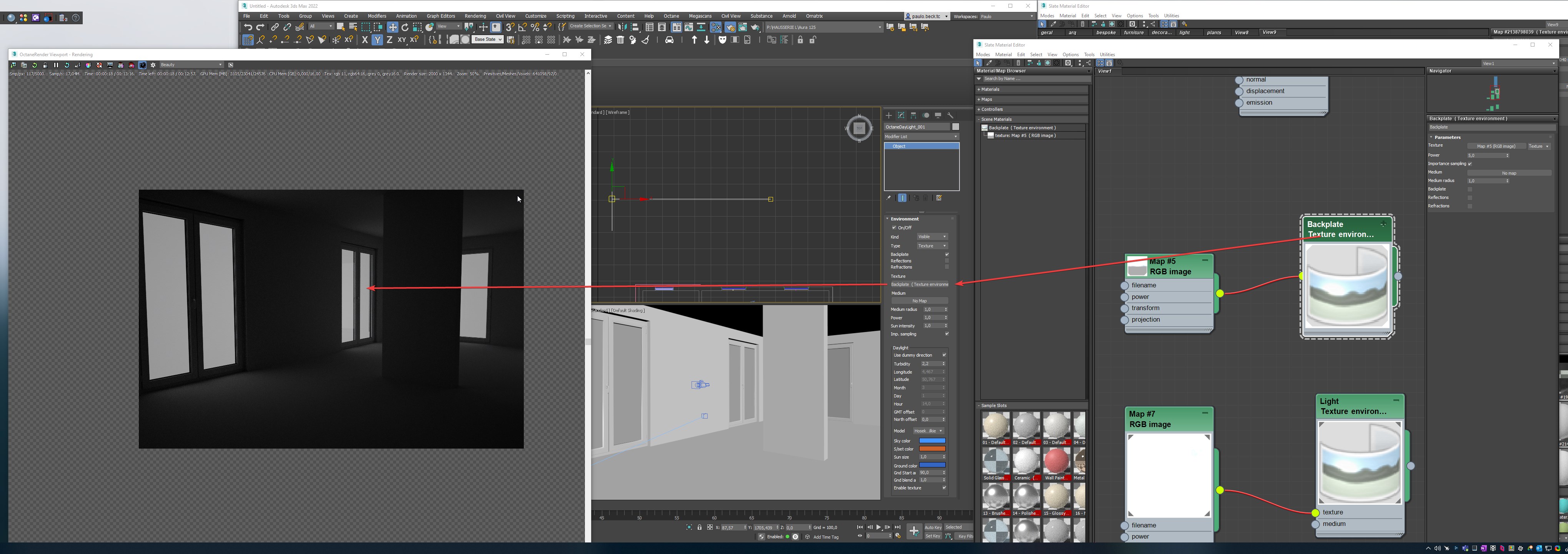

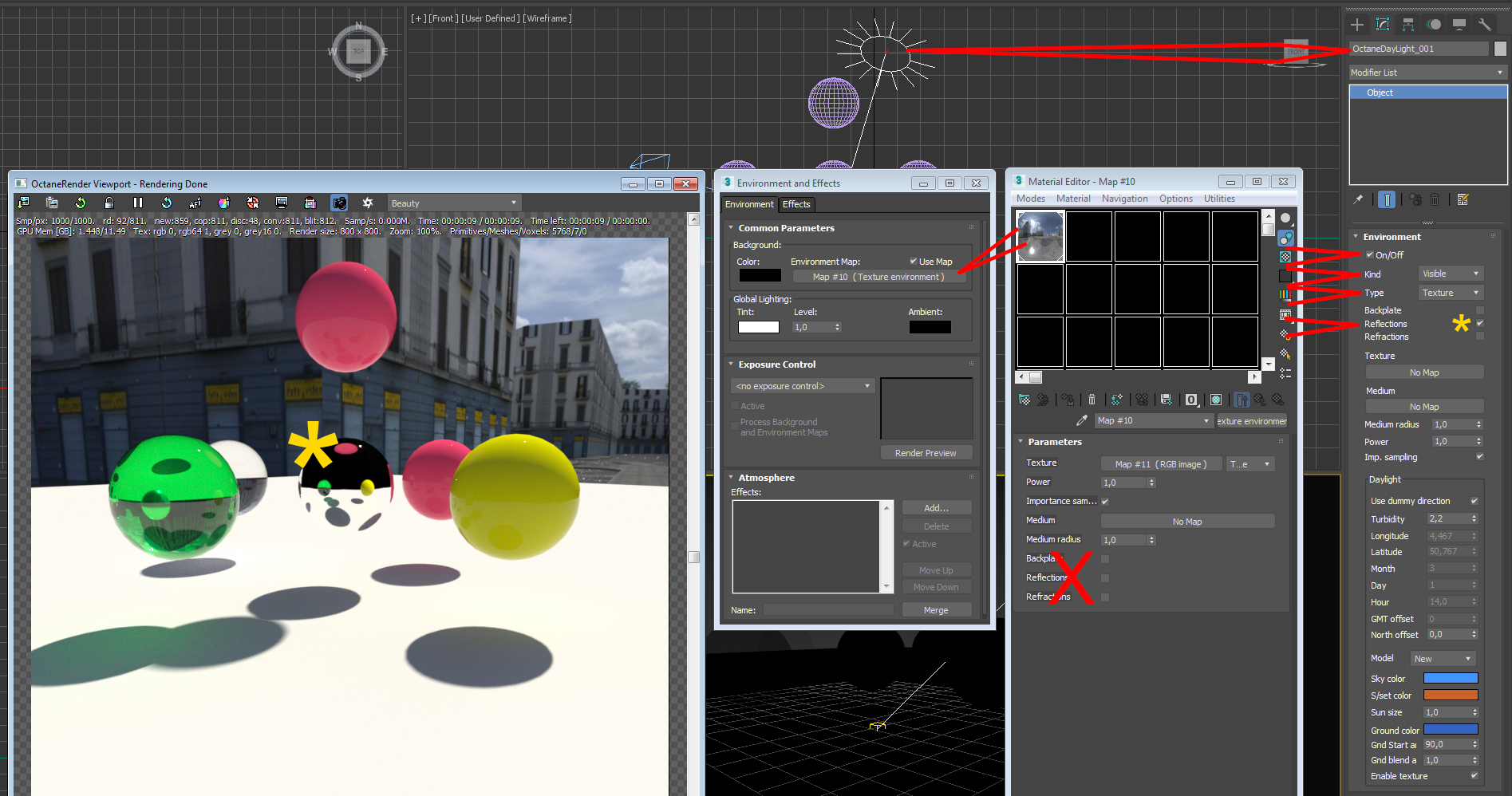

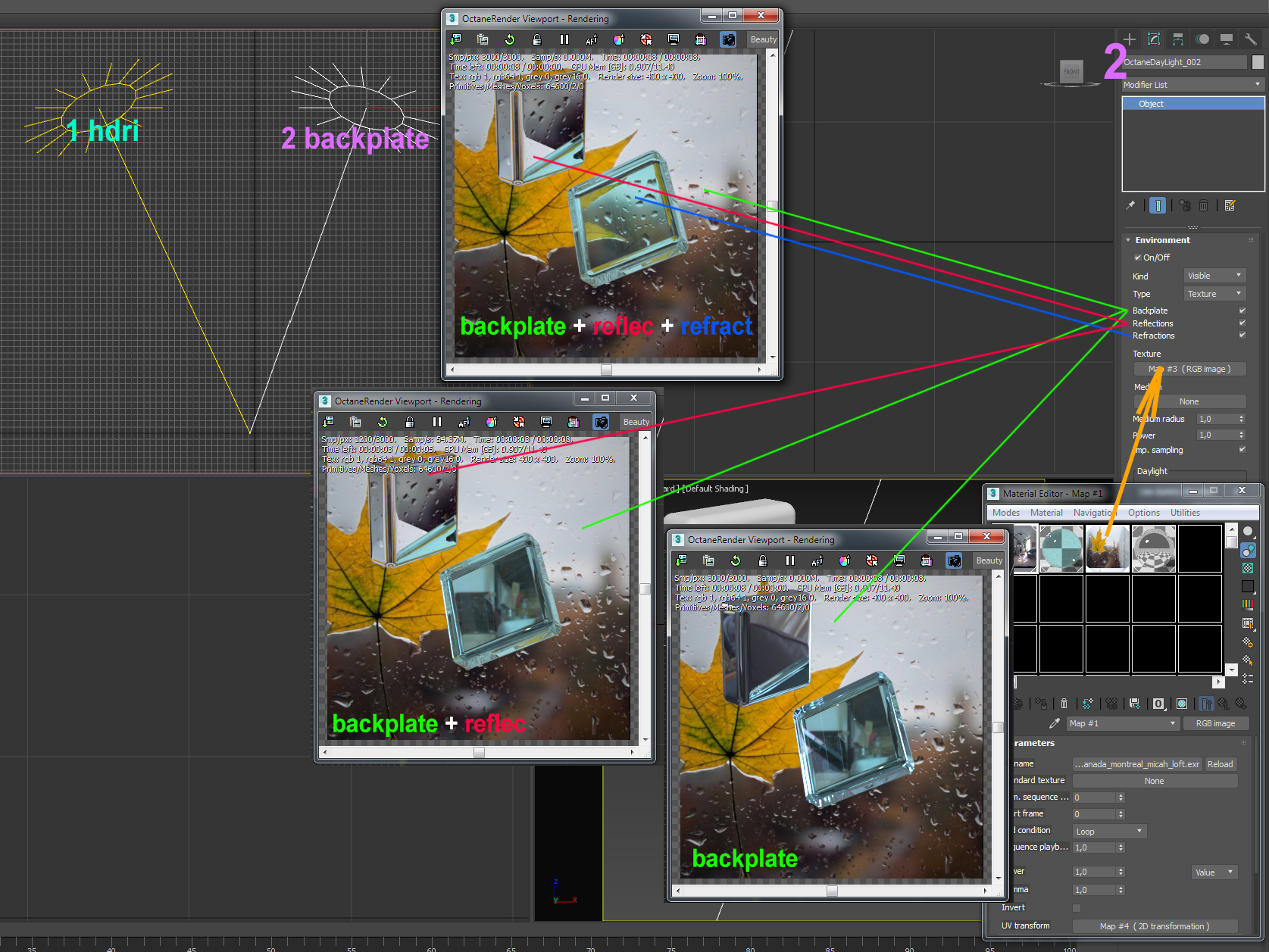

Using HDRi as a backplate (without emitting light) is buggy?
I am using the octane Daylight system to create 2 independent skies

the Backplate option on the evironment teture has also no effect
