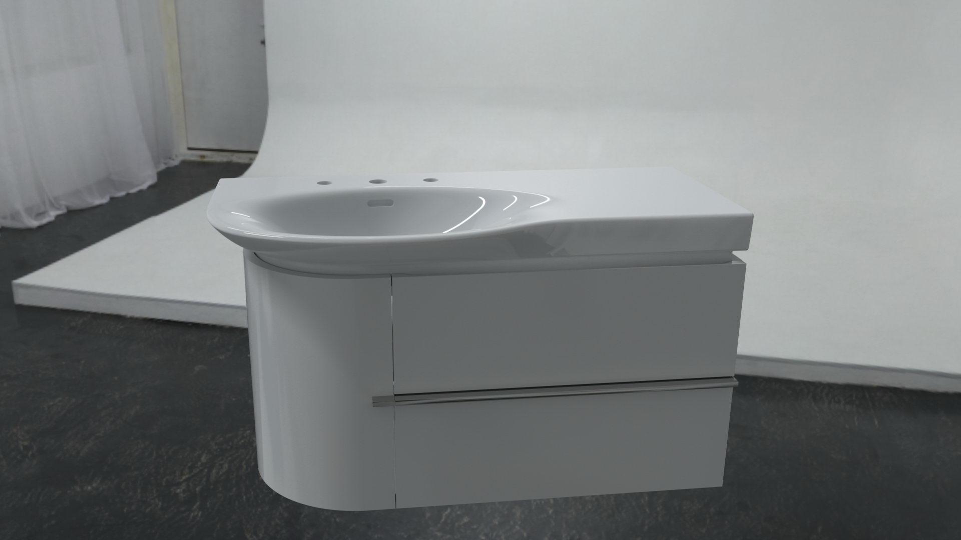

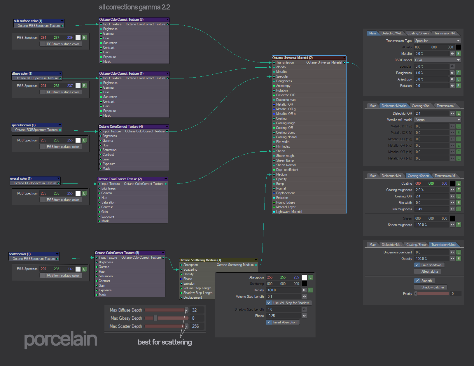

Try my porcelain and possibly modify it.
LW nodes
LW nodes
porcelain.orbx
ORBX material (OCT 2020.2.4)
(11.81 KiB) Downloaded 183 times
porcelain_srf.zip
LW surface (2015.3)
(1.75 KiB) Downloaded 188 times
IPR Preview
IPR Preview

elsksa wrote:
tomas.base wrote:Try my porcelain and possibly modify it.
Hi Tomas, I am curious to know why a γ2.2 gamma-exponent has been applied to all your shading network. Octane should allow you in its preference, to change the color picker from Linear-sRGB to non-linear sRGB (with an EOTF applied, likely the approximation of the piece-wise function) thus making this operation not required.
I don't know how to set it up in Lightwave as far as it goes. The recommendation for the LW plugin is to set all items in colorspace to linear. Then I have to correct the gamma everywhere. It is not in the plugin settings.
If I set the LW setup so that the picked colors match the IPR (Palette files = sRGB, DisplayColorSpace = sRGB, others LINEAR) then I don't have to correct anything, but it doesn't match ShaderBall. It is faster for more complex scenes. And that's the problem, because in a difficult scene, I have to wait a few minutes before I see the result.
Sometimes I use Standalone to create the material, for example a gradient node is badly used without a graphic slider.
I also prefer the LW palette in linear, the default one, because LW2015 under Windows 10 is non-functional in some things about color presets in the palette. It took me a while to figure out how to sync the Modeler. LW is already dead.
I'm moving to Cinema 4D, but I will miss the LW experience from version 5 for a long time.
If someone can set Lightwave so that the RGB spectrum without GAMMA correction in IPR corresponds to ShaderBall, then I'm probably blind, because I tried all the options to set up ColorSpace in LW. Or can someone advise me how.
