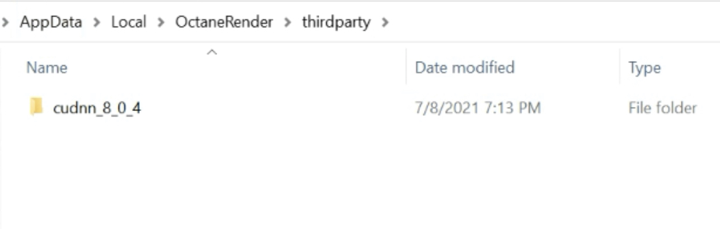

Thank you Beppe - this worked for me! I literally spent hours troubleshooting this issue and could not figure out where to put the dlls. There was no OctaneRender folder in my AppData\Local directory. It would be super helpful if otoy specifies the full directory on the dialogue in future releases! :mrgreen:
Just to note for other users, my downloaded zip was cudnn_8_0_4-win. I had to remove the '-win' for it to be recognized. Only name the folder 'cudnn_8_0_4' (or your version respectively) in your 'AppData\Local\OctaneRender\thirdparty' directory. Your dlls go there.
