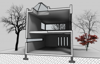

The wonderful tool that Architects love about SketchUp is the ability to do section cuts.
This is a great way to illustrate buildings and architecture in general to the clients and few rendering software are supporting this (as far as I know : Vray and Sketch FX/Ambient occlusion).
It would be such an amazing thing to have that enabled in the Octane Plugin.

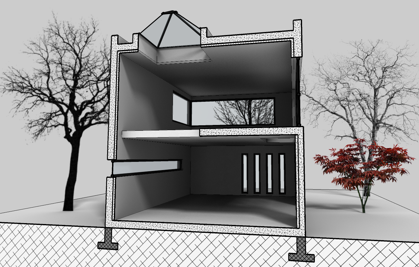

To understand What I'm talking about, see the image attached of a simple rendering done with sketch FX with section cuts enabled.
Please, make it happen :)
Thank you,
Slim
Section cuts enabled

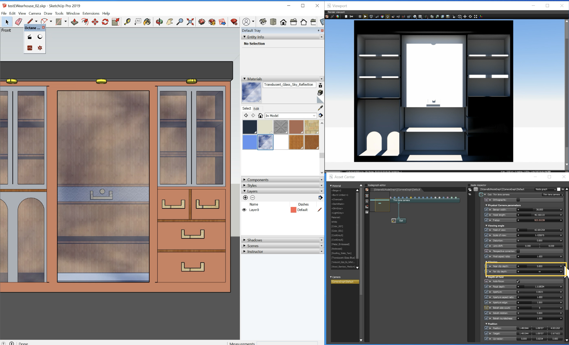

while waiting for Section Cuts, a workaround is to use the Near Clipping Plane option in the Thin Lens Camera node:
If used with Orthographic Camera option, you can obtain the classic section views.
