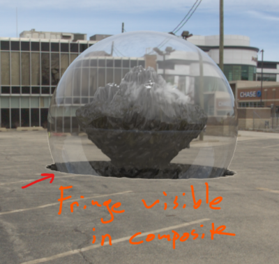

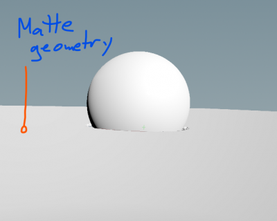

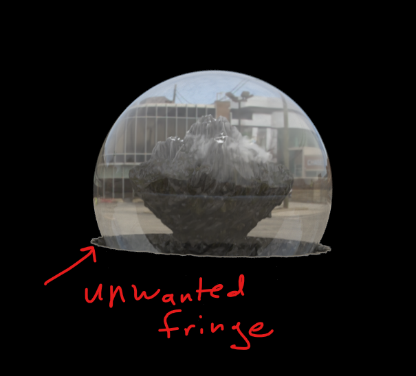

Hi Juanjo;
This method more or less works, with one exception:
I have a reflective/refractive object that I would like to mask for compositing purposes. I can add the "matte" geometry to my scene, and use Render Passes as you describe above to hold out the geometry the way I need. But: the renderable geometry seems to reflect/refract the matte object itself.
So this means I need to decide what shader to put on it. I'm using the OSL Projection trick mentioned elsewhere in this forum to project a background plate onto my matte geometry. To do this, I connect an RGB texture to the Emissive slot of the diffuse material, and set Diffuse itself to be 0.
What I see now is sort of a bright 'halo' around my object; it's as if my geometry is being pre-composed with the matte/emissive geo before the final image is written
I'll try to share some images here that explain the problem:
