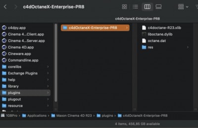

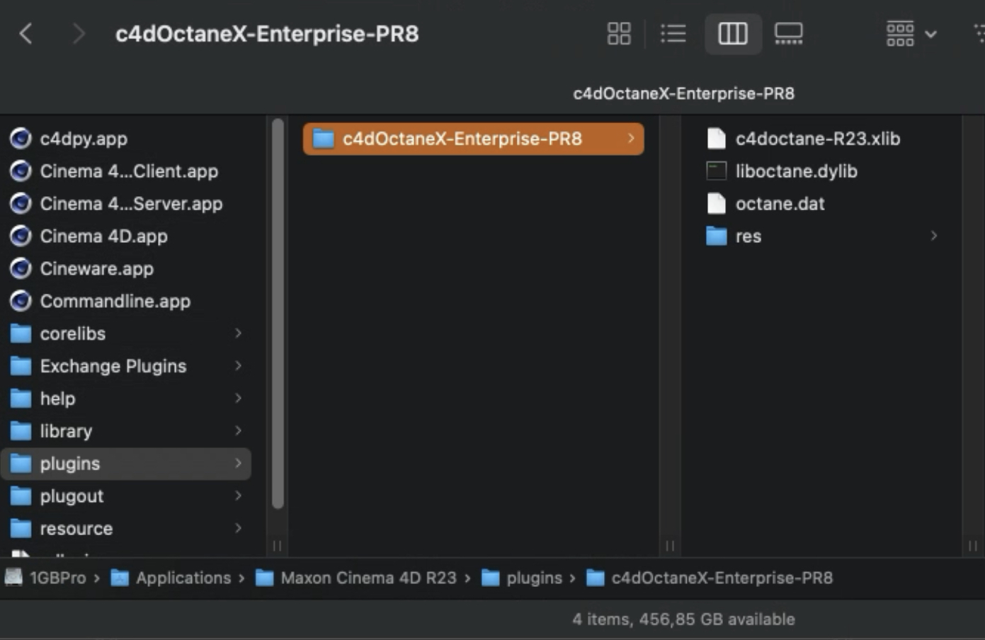

You need to create the plugins folder inside the c4d R2X directory.
The installation paths for Mac is:
HD\Applications\Maxon Cinema 4D R2X\plugins\c4doctane (You have to create the plugins folder!)
Note that you always need to remove from the c4doctane folder, all the unnecessary c4doctane-R2X.xdlib files not related with R2X specific version, and leave only one c4doctane-R2X.xdlib file in ../plugins/c4doctane directory.

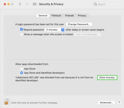

To finish the installation, you need to allow the c4doctane plugin and library in System Preferences/Security and Privacy panel, and restart C4D a couple of times.

I'm having issues getting this going...
Does OctaneX-Enterprise-PR8 work with Cinema R23 on M1 Macs with macOS Big Sur 11.2.3?
I've done the Security & Privacy thing when launching but Octane never shows up in Cinema.
Any help is appreciated.

Agreed. I have verified that I have Rosetta 2, allowed all permissions necessary, and still Octane will not load in C4D. I can get things to work in Blender, and I can get the standalone to render, but there is nothing I have been able to do to get it to work in C4D. Is this still a known issue? Has ANYONe been able to get C4D plugin for Octane to run on an M1 Big Sur Mac?
