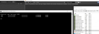

23.3 server doesn't respond after starting rendering a scene.
Is that only for me?
Octane server(PID:15300) listen to connection on 0.0.0.0:5130, 5131.
Blender shows an error 'Render-server at address 127.0.0.1 is not activated' on the top of render window.
It may be windows update's failure, I don't know.
Windows 10 Home 20H2 build 19042.867

roentgen
Posts: 29
Joined: Fri Jan 08, 2016 2:10 pm
oh that was so terrible. okay I'll ask support.
Thanks for your information,
roentgen
Posts: 29
I found a workaround; Use 'Run as administrator' to start OctaneServerStudio, then I got an image from renderer on blender. :beer:
(TRY THIS YOUR OWN RISKS BECAUSE THIS MAY HAVE A SECURITY RISK)
