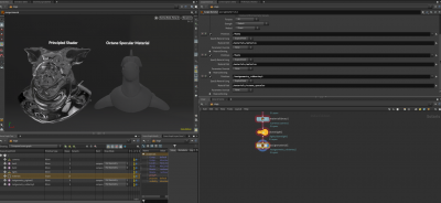

Either i'm doing something wrong or octane materials don't work at all.

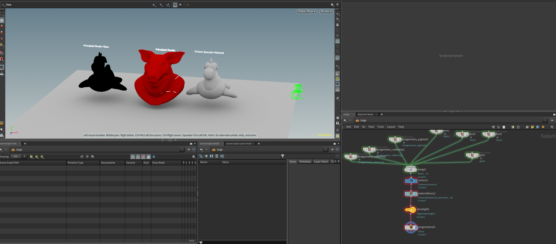

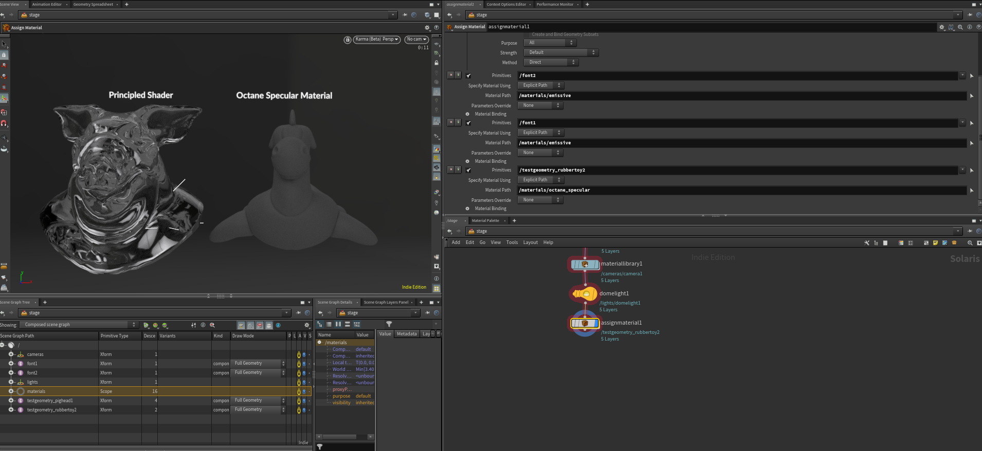

Oh yea, my bad with the screenshot. I was switching between renderers to see if Principled Shader worked in others. I've attached a new screenshot and a hip file.
For some reason, Principled Shader with transparency(Glass) returns black. Fixed this by adding a Render Settings node. Guessing the default specular depth is 1.

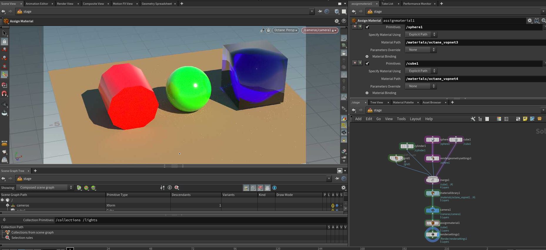

Currently, Octane material is not working with the test geometry maybe the shaders are baked into them. This is a known issue to us.
We have tried to replicate your workflow and Octane Materials is working fine with other primitives.

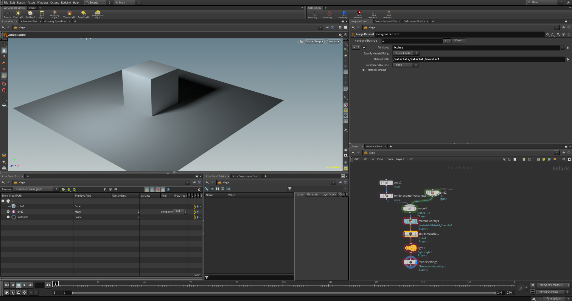

The test geometry was working fine in the previous version. Maybe you were right about the baked shaders, but even after deleting them, still doesn't work.
Here is a scene with just a simple cube with a specular material. Still doesn't work. I used the principled shader just for testing to see if i was doing something wrong or Octane Materials just weren't working for me.

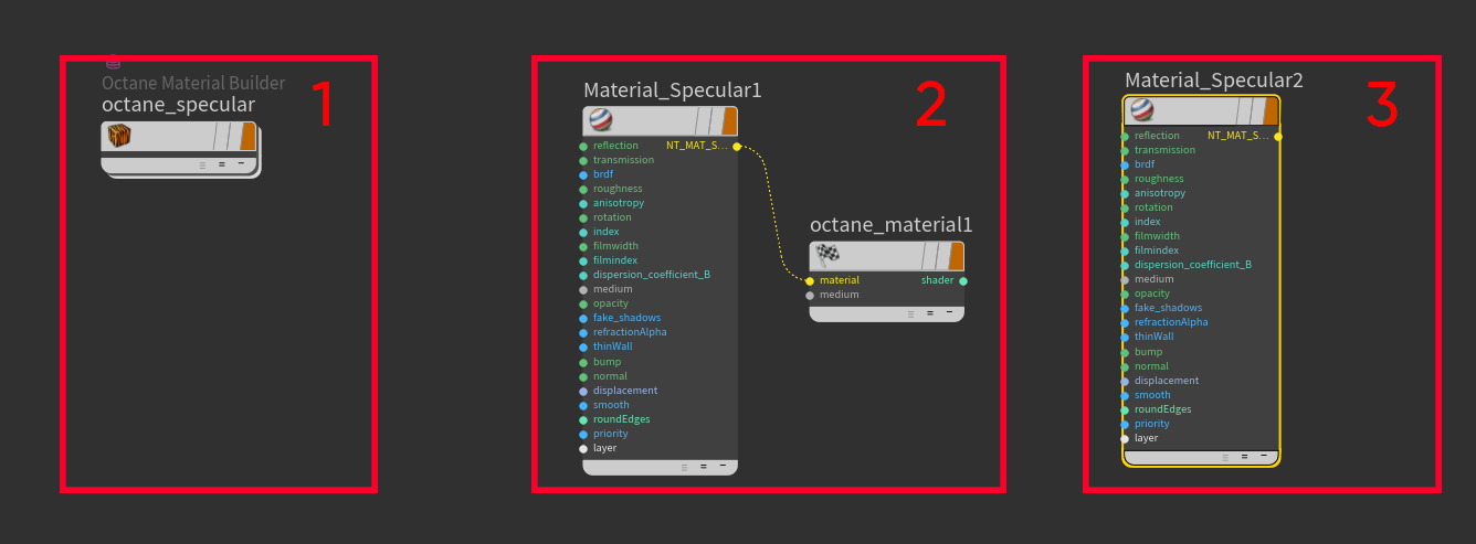

Ok. I got it working. In order for the Octane Material to work, it has to point either to an Octane Material Builder(1) or OUT_Material node(2). It wont work if it points to the Material Node(3).
In the regular Houdini workflow, pointing to the Material Node works just fine. Guess it doesn't work in Solaris that way.

Thank you Galleon27, for your feedback.
Yep, we would need to point the out node or the Material builder.
We will try to see if we can keep the same workflow as Solaris in the future build.
