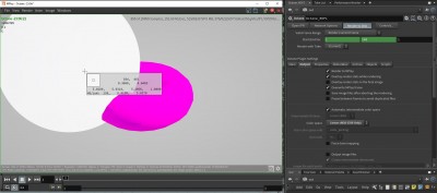

Currently, if there is no OCIO config the IPR always works in sRGB color space mode, so this is why the MPlay gamma is set to 1.0 to avoid the double gamma correction. For the final render to disk the ROP node color space option is used, so if you configure it to linear, you should get a linear non clipped .exr file and MPlay preview, as you can see in the attached image.
