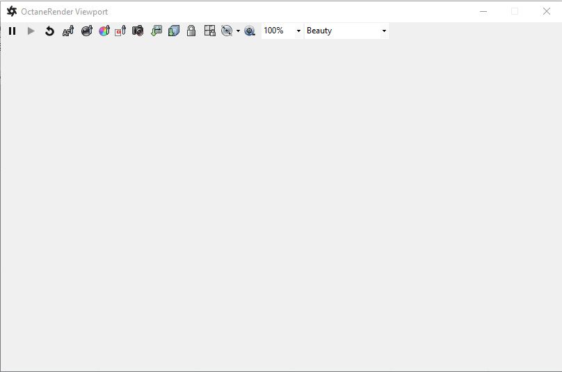

I just installed a new RTX 3060 card and reloaded Nvidia drivers.
Octane 4 is activated and behaves normally until the render window pops up with not content (see attached screenshot).
Any additional configuration I need to enable or disable features on 3060 to make this work?
Thanks!

Hi. Have you upgraded to the latest Nvidia drivers? It may be that GTX 3000 cards will not work with Octane 4, and you need to upgrade to Octane 2020. But you will need to check all this with OTOY.

Was there any info on this. Ive just bought a 3060 and got the same blank screen.

alfabruce wrote:Was there any info on this. Ive just bought a 3060 and got the same blank screen.
Cheers
Tim
Hi Tim - Can you post a screenshot of the plugin Devices->"Open Device Settings" panel pls?
Also - I suggest submitting a ticket to OTOY asking if Octane 4 will render with a 3060.
